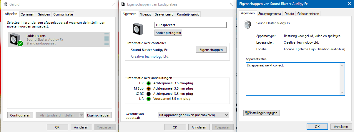

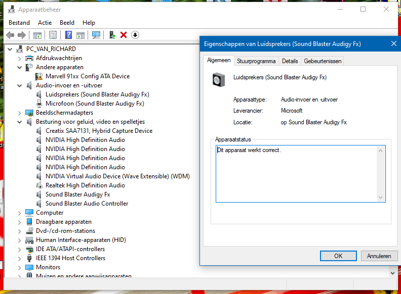

    1. In the playback devices list, I now only have Speakers (showing disabled and disconnected devices). The controller is "Sound Blaster Audigy Fx", but when I click properties the location is: "Location 1 (internal High Definition Audio-bus)": (Dutch version of Windows) Sound issues after switching Power Supply Unit c7ee2924-6041-474d-bc97-9df8de6e7453?upload=true.png In the device manager, the "Speakers (Sound Blaster Audigy Fx)" location is "on Sound Blaster Audigy Fx". So that is different. Sound issues after switching Power Supply Unit 669868ac-5b13-403f-b86f-c1ff8d807c12?upload=true.png

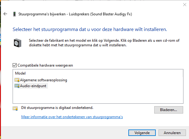

    2. I read on the internet that updating the driver could help. I would have to go to Device Manager > Speakers > Update driver > Search for driver software on my computer > Choose from list of drivers on my computer > High Definition Audio device.
      The problem is, i can't choose that driver. I only have two options:
      - General Software solution;
      - Audio-Endpoint (Current driver)
      Sound issues after switching Power Supply Unit 0bde15b0-3c2d-40de-a60d-78ce2c92c489?upload=true.png
    I personally suspect that the missing "High Definition Audio device" is what is causing the problem. But i don't know how to fix this.
