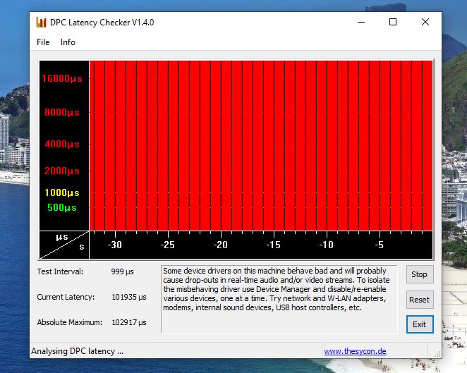

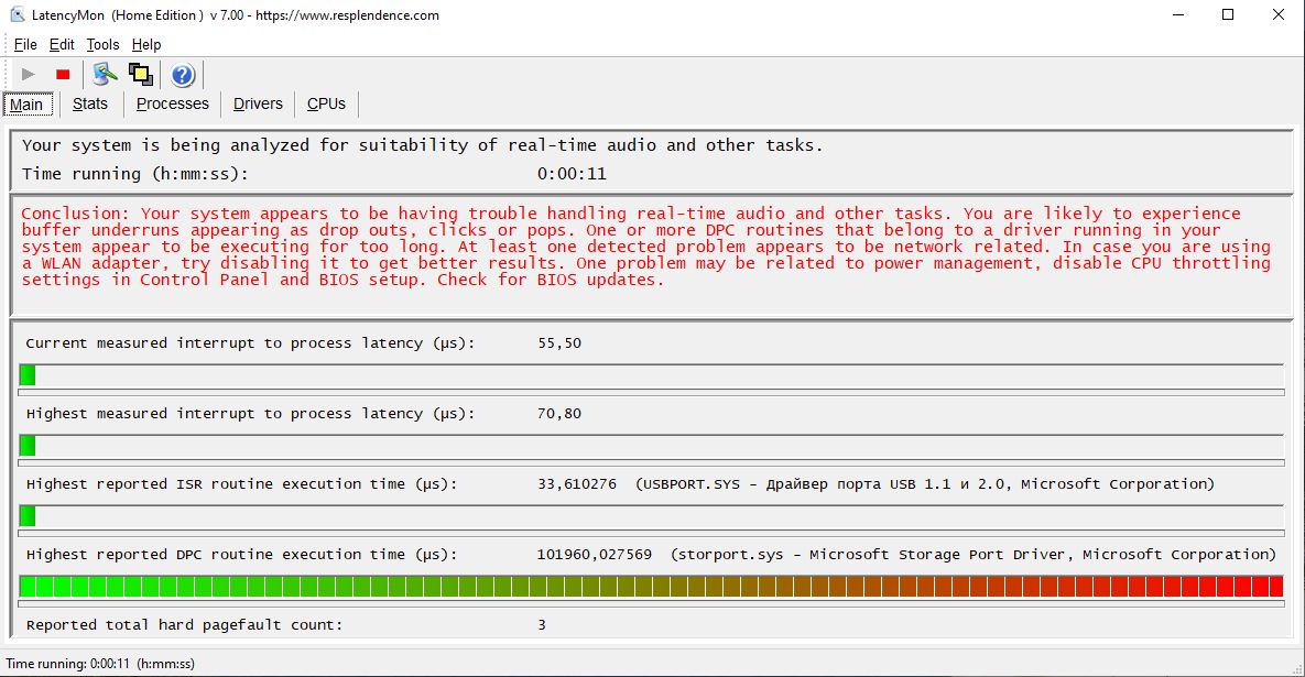

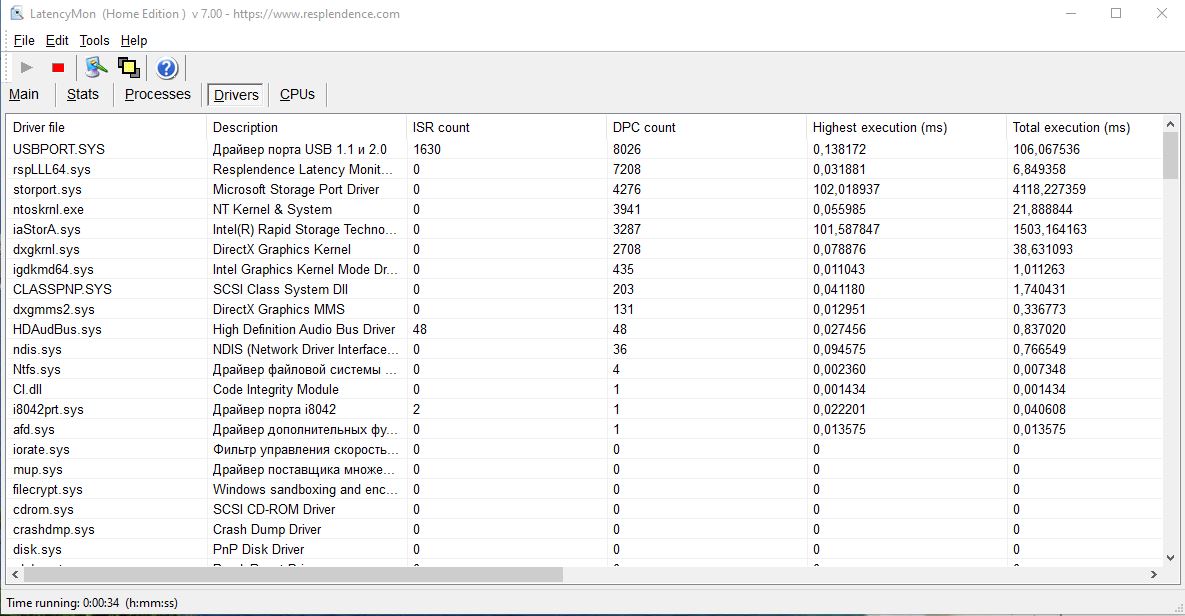

    Then I've installed LatencyMon and DPC Latency Checker programs there were identified delays caused by incorrect operation of the drivers. The highest score was for "USB 1.1 and 2.0 Port Driver".
    Screenshot # 1

    Screenshot # 2
    Sound microfreezes and system interrupts 924bf01c-0a93-487d-9638-f5f8f37c8a76?upload=true.jpg
    Screenshot # 3
    Sound microfreezes and system interrupts b36b3a53-6f22-41d8-940c-703ae42525f6?upload=true.jpg
    What I've done next: all devices in the "USB controllers" branch from the Device Manager were deleted, then the laptop was rebooted, and the sound freezes stopped! LatencyMon also showed no latency. It was a wonderful few days
    And then another forced Windows 10 update happened, the problem came back again. No methods helped, LatencyMon still shows the latency for this "USB 1.1 and 2.0 Port Driver" driver. The second most latency driver is the Microsoft Mass Storage Port Driver and the High Definition Audio Bus Driver.
