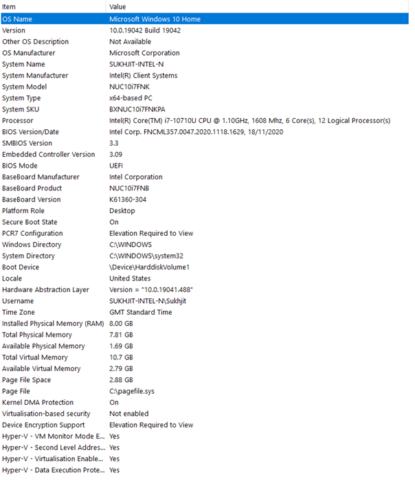

    Background to Problem
    I have recently purchased an Intel NUC10i7FNK and this is the system information: -

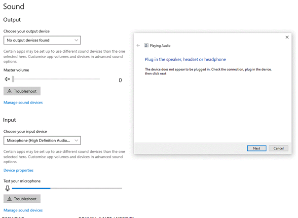

    Sound Problem
    On first use, the 3.5 inch jack worked and I could use the machine with my headphones
    I then actioned the initial window and BIOS updates after which my sound stopped working through the 3.5 inch jack
    I have tried multiple headphones which work on other devices but absolutely no sound after update
    Sound through 3.5 Inch Jack has Stopped after Windows Update; Realtek Driver cannot be... 961f47d7-1363-4126-a373-c28caf535961?upload=true.png
    Sound through 3.5 Inch Jack has Stopped after Windows Update; Realtek Driver cannot be... 7b2f534f-f342-4489-b750-4daf45666a23?upload=true.png

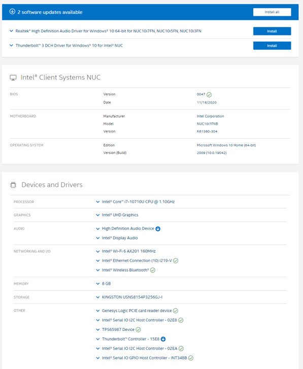

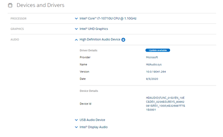

    Cause
    From Intel diagnostics, there is a Realtek driver which needs to be installed but cannot be installed because a Microsoft driver is present and prevents the installation of the Realtek driver
    Missing Driver Details
    Sound through 3.5 Inch Jack has Stopped after Windows Update; Realtek Driver cannot be... a1bb2bf1-e111-4a84-ac8c-57f80c749425?upload=true.png
    I understand from the Intel diagnostics utility see above that the Realtek driver needs to be installed for the sound to work

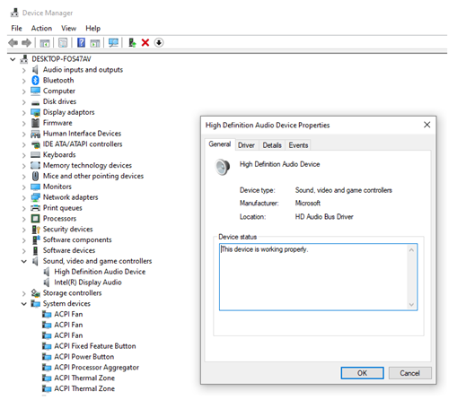

    Existing Microsoft Driver
    Sound through 3.5 Inch Jack has Stopped after Windows Update; Realtek Driver cannot be... 4ebf18af-7135-4e42-b6a6-fff566b9ae27?upload=true.png
    This driver cannot be un-installed
    Sound through 3.5 Inch Jack has Stopped after Windows Update; Realtek Driver cannot be... 00fcb9a7-519b-46cb-bb7a-047d750c094f?upload=true.png Whenever it is un-installed then it will re-install itself when the machine is re-booted
    After un-install if another driver the Realtek driver is attempted to be installed then instead the Microsoft driver will re-install.

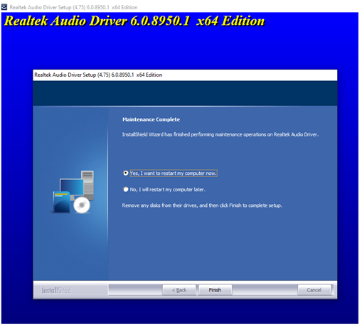

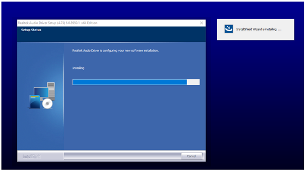

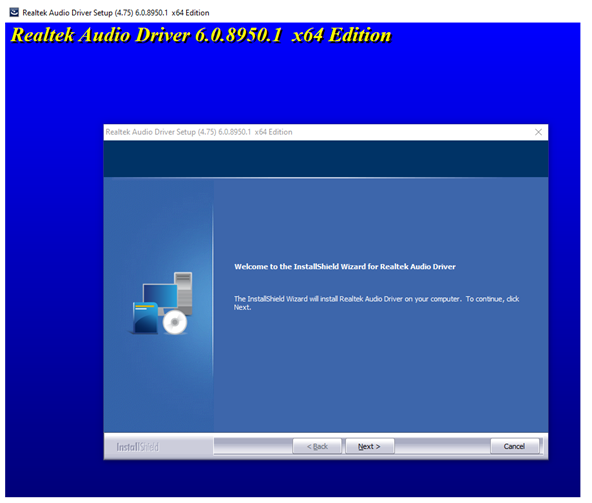

    Driver Installation Attempts
    The screen below show what happens when the installation is attempted
    Sound through 3.5 Inch Jack has Stopped after Windows Update; Realtek Driver cannot be... 9f224b3f-3024-4683-90ca-bbc82839b59e?upload=true.png
    Sound through 3.5 Inch Jack has Stopped after Windows Update; Realtek Driver cannot be... f9f014eb-254b-400c-92e9-95a69c0c59ad?upload=true.png
    Sound through 3.5 Inch Jack has Stopped after Windows Update; Realtek Driver cannot be... 939c805e-cb6d-48cd-9d6f-9df9321f4710?upload=true.png
    Unfortunately, the Realtek driver fails to overwrite the Microsoft driver
    If the Microsoft driver has been previously removed, then that driver re-installs itself

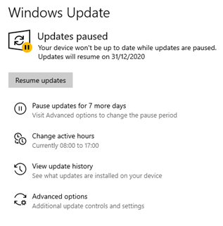

    I have tried to do this by suspending windows updates during the driver install process but this has not worked either
    Sound through 3.5 Inch Jack has Stopped after Windows Update; Realtek Driver cannot be... dd7f37f8-c84d-4ebf-a851-9ab094b4d9c1?upload=true.png

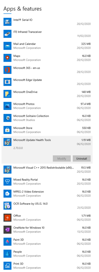

    Application Possibly Causing Problem
    Sound through 3.5 Inch Jack has Stopped after Windows Update; Realtek Driver cannot be... 57a2f54b-ad3d-4992-997d-7fba4682dc08?upload=true.png

  2. Jayce Win User
    The Ultimate Realtek HD Audio Driver Mod for Windows 10
    I had the realtek error when using the installer, so I did these step and It Worked
    1.Go Open up device manager
    2. Go under sound,video, and game controllers
    3. Find Realtek High Definition Audio
    4. Right click and hit update driver
    5. Browse my computer for driver software
    6. Let me pick from a list of available drivers on my computer
    7. Click Have Disk and hit browse
    8. Click on the Realtek HD Audio mod folder and look for win64
    9. Click on the HDXRT4 and click ok,
    10. Click Next and Yes
    After it is done, restart the PC
    You should be good then and also make sure before doing these steps that you have driver enforcement disabled.
    Jayce, Dec 30, 2020
