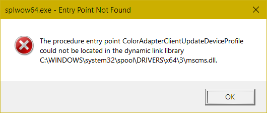

    After the reinstallation, my printer stopped working. When I click print in Microsoft Word, this appears:
    splwow64.exe - Entry Point Not Found e370e13e-9b01-49e7-a4cb-3c51ccc258fa?upload=true.png
    It says: The procedure entry point ColorAdapterClientUpdateDeviceProfile could not be located in the dynamic link library C:\WINDOWS\system32\spool\DRIVERS\x64\3\mscms.dll.

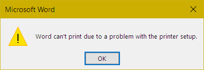

    I could click ok, but when I try to print the document, another error box appears:

    I have tried several things thus far, but my printer still does not work:
    • Stopped and restarted the printer spooler.
    • Did some edits to the registry I'm not sure what I did, I just followed some of the instructions found online.
    • Uninstall and reinstall the printer, both USB and wireless.
    • Contacted Canon, to which they troubleshooted and said that the driver has been installed fine, it is now a Windows a problem.
    I've searched everywhere for a solution, the only thing I haven't tried is to download and replace the mscms.dll file I'm not sure what it is. I'm thinking that it might be a registry thing that was deleted, but I'm not entirely sure.
    Any help would be appreciated. Thanks!
