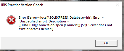

    Hi
    When trying to open my software programme I'm getting the following error message -
    SQLExpress server does not exist or access denied - Windows could not start SQL server... 726c79f3-b696-442d-bcef-8fb2d99d9162?upload=true.png

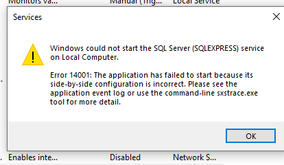

    I've tried going into services.msc as instructed by the software support team to restart/start the sqlexpress - but at that point I get the following message -
    SQLExpress server does not exist or access denied - Windows could not start SQL server... 44d3e98e-09b3-4145-a012-4fc3532acdd9?upload=true.png
    When reviewing the application event log - the side by side error reads as follows -
    Activation context generation failed for "C:\Program Files\Microsoft SQL Server\MSSQL10_50.SQLEXPRESS\MSSQL\Binn\sqlservr.exe". Dependent Assembly Microsoft.VC80.ATL,processorArchitecture="amd64",publicKeyToken="1fc8b3b9a1e18e3b",type="win32",version="8.0.50727.4053" could not be found. Please use sxstrace.exe for detailed diagnosis.
    I've tried repairing Microsoft visual c ++, uninstalling and reinstalling it - as they suggested - but the programme still won't open. They've now left me with the response "it's a windows issue and we can't help".
    Everything seemed OK until an update was installed yesterday - I've tried restoring the PC to before the upgrade but still no joy.
    Any advice would be appreciated!
    Thanks
