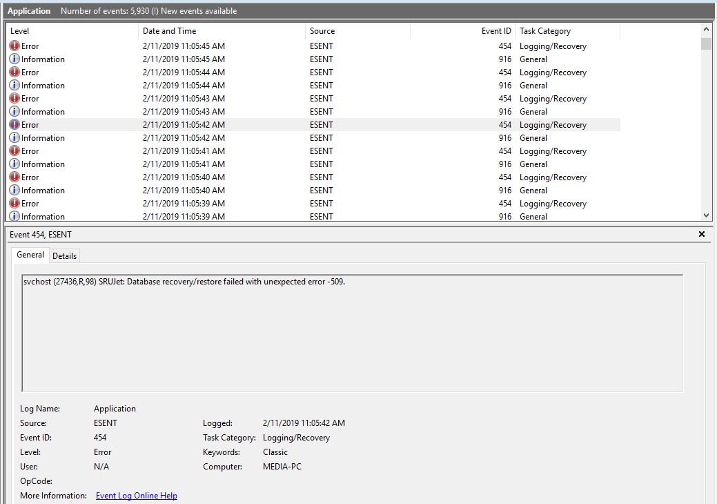

    On Windows 10 Pro I am getting Event ID 454, "SRUJet: Database recovery/restore failed with unexpected error -509" and Event ID 916 "The beta feature EseDiskFlushConsistency is enabled in ESENT due to the beta site mode settings 0x800000." logged to the application log multiple times per second.
    "SRUJet: Database recovery/restore failed with unexpected error -509" multiple times per second 27dbc71f-88f2-4927-aa31-be14babfd706?upload=true.png
    If I shut off the Diagnostic Policy Service, these errors stop. When I turn DPS back on, I will see one of each of those errors immediately and then after some time (sometimes a few minutes, sometimes near an hour), I will see multiple per second (as shown in the picture above).
    I've checked in C:\Windows\System32\SRU and see a few log files, but no SRUDB.dat (which seems to be the DB indicated by SRUJet). Some other posts have suggested deleting this file and let DPS rebuild it - but I cannot even find it.
    I tried manually putting SRUDB.dat in that folder, but the same errors happen (actually, starting DPS deletes the file I put there).
    I have run sfc /scannow which completes with no errors.
    I have also run DISM /Online /Cleanup-Image /CheckHealth (and /ScanHealth and /RestoreHealth) - all no issues.
    Any other ideas?
    Aggregate J, Feb 11, 2019

    Mark, thanks for the hint.
    My symptoms were:
    - No thumbnails displayed
    - Green bar loading forever
    - Explorer essentially unusable
    Rebuilding the icon cache (the commonly suggested fix) and SFC had no effect.
    I looked in the Event Viewer as you suggested and found continuous errors (about 1 a second) from SearchIndexer ("Database recovery/restore failed with unexpected error -590.").
    Found this result:
    Database recovery/restore failed with unexpected error 509
    which referenced error 509 instead of 590, but it pointed to a problem in the directory C:\Users\xxxxx\AppData\Local\TileDataLayer\Database\
    I removed all the files I could in that directory (2 were in use), then opened Windows Indexing Options and rebuilt the index.
    Problems immediately fixed (before the index finished rebuilding).
    My particular fix may not work in your case. Follow Mark's suggestion and check the event log for clues.
    t.bridgman, Feb 11, 2019
