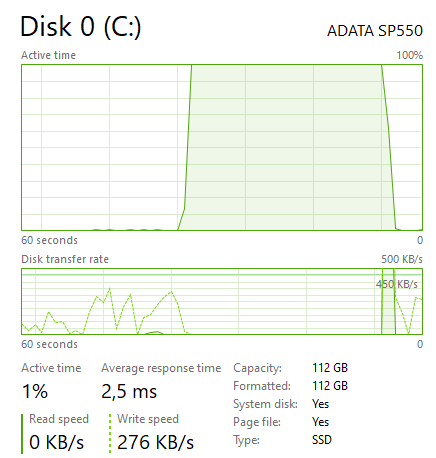

    Hi.
    So ever since the 20H2 update, my computer randomly freezes with disk active time sitting at 100 with no read and write. I can move my mouse and I can move Windows around, but I can't click on anything or alt+tab. It happens while navigating different windows and browser tabs. For example closing a Youtube tab, or opening Paint. I can play games for hours straight and it won't happen once.
    SSD disk active time at 100 with no read/write 3d6a5893-9f4d-472b-a100-53aa63bcbb38?upload=true.png

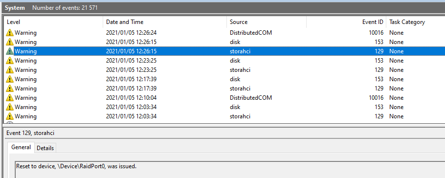

    What the error log says:
    SSD disk active time at 100 with no read/write b6f988d1-6f38-4474-9546-c8ba4f41f737?upload=true.png
    I've had this exact same issue before and the fix then was to change MSISupported in Computer\HKEY_LOCAL_MACHINE\SYSTEM\CurrentControlSet\Enum\PCI\VEN_1022&DEV_7901&SUBSYS_7A331462&REV_51\4&2b9cc193&0&0241\Device Parameters\Interrupt Management\MessageSignaledInterruptProperties from 1 to 0, however this time it hasn't worked.
    What I've tried:
    1 Ran file check sfc /scannow
    2 Ran check disk scan
    3 Changed the registry key mentioned above
    4 Changed the SATA cable
    5 Changed the power plan settings to high performance
    Specs:
    MSI 370 Gaming Plus motherboard
    Ryzen 5 1600 CPU
    ADATA SP550 128GB SSD About 2 years old
    16GB Balistix 2400 DDR4
    Nvidia GTX 1070
    Windows fully up to date. Running built in WIndows AHCI drivers where I think the problem possibly could be.
    Any guidance would be appreciated.
    Rudidl, Jan 5, 2021
