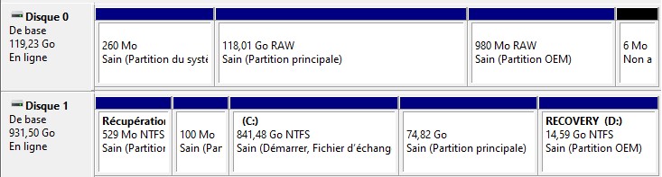

    Hi everyone,
    So the other day, my laptop had a blue screen I think it was Your windows insider version encountered a problem, code error: unfixable error or something like that
    After the restart, it wouldn't boot into windows and get prompted "Please install an operating system" So after getting a bootable Windows USB, I installed it on my hard drive not the SSD cause I didn't get the choice to do so anyway, long story short, using DiskPart I was able to identify that the SSD file system became RAW, again with DiskPart and 3rd party programs, I tried to format it back to NTFS but didn't know how/didn't work.
    Same story with booting into Ubuntu and trying to wipe/format the drive.
    My theory is, somehow it is still recognized as a "valid, bootable" windows drive, correct me if I'm wrong.
    So I'm looking for a way to make my SSD usable and transfer the operating system to said SSD.
    Here is a screencap of what I see in the disk manager sorry it's in french
    SSD turned to RAW format after blue screen 77af6a6e-c55d-4e17-9192-7cd8f8834b03?upload=true.jpg
    Kokobong, Apr 28, 2020
  2. topgundcp Win User
    Save RAW drive - Don't want data
    Open Admin command prompt, then type:
    1. diskpart
    2. list disk ======> Take note of disk # of the RAW drive
    3. select disk # ======> is the number in step 2
    4. clean
    5. exit
    Open Disk Management and initialize it, Create Simple, format.
    topgundcp, Apr 28, 2020
