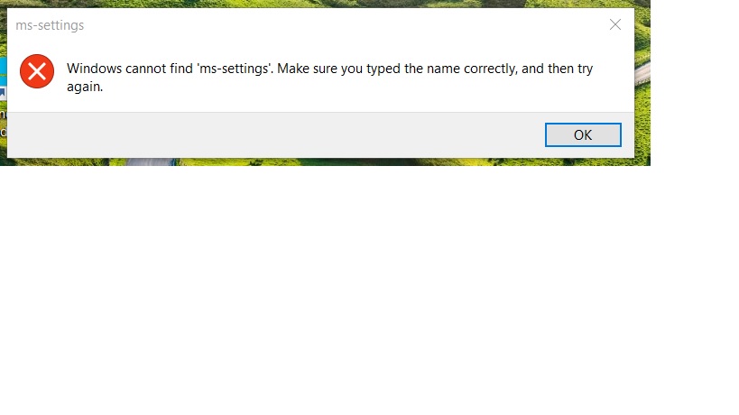

    I tried updating to Windows 10 version 1903 and it wasn't successful. It said the error was "Potential Database error detected."
    The other day, my notebook wasn't able to shutdown properly because the battery got drained. I didn't know if it was updating or what but when I tried open it there was a black screen and I didn't know what to do so I restarted it by long pressing on the boot button. I think I did it thrice- I'm not sure. When I finally got through my desktop view, the start up menu was not working.
    I tried to follow the troubleshooting guide here but it didn't fix the problem. this is the error I encountered when I tried to access windows settings ( windows key + R then type "ms-settings:" )

    I suggest you to refer the link below and follow the troubleshooting steps suggested.
    Troubleshoot problems opening the Start menu or Cortana.
    http://windows.microsoft.com/en-in/windows-10/get-help-windows-start-menu
    Hope the Start menu works after performing the steps suggested. Thank you.

    I found the following article, ran the suggested powershell command and my start menu is working again. Here it is as I found it:
    Go to Start menu button and right click on it. This will open the contextual menu, after which you need to select Command Prompt (Admin). Once Command Prompt is open, go ahead with the following steps.
    • Type and enter: Powershell
    • Type the following: Get-AppXPackage -AllUsers | Foreach {Add-AppxPackage -DisableDevelopmentMode -Register “$($_.InstallLocation)\AppXManifest.xml”}

    Hello Barry,
    Please help us with the below information to help you better.
    • Have you installed all the pending updates on your system?
    • Did you make any recent software/hardware changes to your computer?
    As an initial troubleshooting step I would suggest you to install all the pending updates on your system and if you are using Microsoft account suggest you to sign out and sign in again and check if resolves the issue.
    I suggest you to perform Start menu troubleshooter
    from the below article and check if it help in addressing your issue.
    Get help with the Windows 10 Start menu:
    http://windows.microsoft.com/en-us/windows-10/get-help-windows-start-menu
    Let us know if you need any further assistance on Windows related issues and we will be glad to help.
