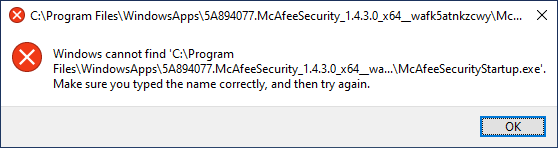

    stop annoying dialog about mcafee on startup/login
    Since the last program update to McAfee, every time I log in to my computer I get an annoying dialog box about "Windows cannot find 'C:\program files\WindowsApps\5A894077.McAfeeSecurity_1.4.3.0_x64_wa...\McAfeeSecurityStartup.exe'.
    Make sure you typed the name correctly and then try again."
    stop annoying dialog about mcafee on startup/login 9930dbd9-5a38-49bd-bd17-3c49151f80b7?upload=true.png
    I cannot locate where Windows is being told to look for this item.
    It seems msconfig is depreciated for startup items, the thing it tells me to look at instead in task manager has no reference to a "McAfeeSecurityStartup.exe", There is no startup folder on the Start menu. I've downloaded the Systems Internals Suite and I cannot find any reference to a McAfeeSecurityStartup.exe in autoruns64.exe either when looking at the everything tab. I've looked both with my normal standard account and running autoruns64 as an administrator using my other (administrator) account's credentials.
    I've also downloaded and run CCleaner.
    Where else would I look to get rid of this annoying dialog? I'm about ready to uninstall McAfee, since the subscription expires next month anyways and I'm thinking of switching to Avast like I have on my other, older computers. McAfee came with a free one year subscription with the computer.
    SlickRCBD, Sep 12, 2019
