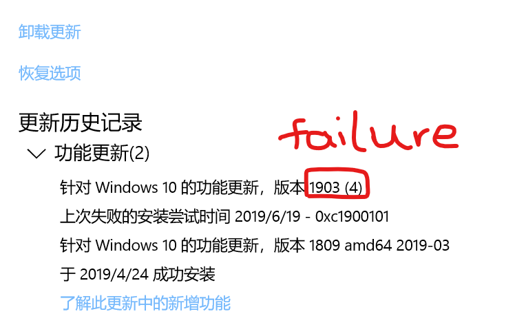

  1. Stuck multiple times at 89% while updating Windows 10 to version 1903
    Recently I tried to update win10 to the latest version 1903, but it failed multiple times: always stuck at 89% with the same error code: 0xC1900101-0x4000D, indicating installation failed during the stage of SECOND_BOOT while attempting MIGRATE_DATA. I also tried Media Creation Tool after trying the regular windows update. It failed also with the same error code.
    Here are the log files you might need to figure out what is wrong with the update:
    1. The Panther logs. Files named Setupact.log and Setuperr.log https://1drv.ms/u/s!An9wNW9q9BMBmRe3n3n_QqxU9h41?e=y6RgNw
    2. The Rollback logs: Files named Setupact.log and Setuperr.log https://1drv.ms/u/s!An9wNW9q9BMBmRjP6Lkoo3g7ShN7?e=N4CPT4
    3. The Device Install Logs from C:/$Windows.~bt\Sources\Rollback\setupapi\ : https://1drv.ms/u/s!An9wNW9q9BMBmRwZGiNKTHP-TMJG?e=6iBhIZ
    4. By the way, i have never encountered with blue screen.
    Current System
    Edition: Windows 10 Home
    Version 1803 installed on 05/12/2018
    OS Build 17134.885
    CoinChimera9683, Aug 4, 2019
