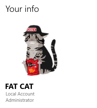

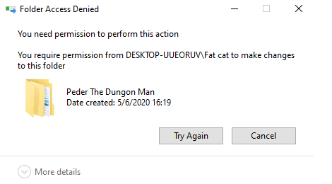

    Since adding a new account on this computer I think at least this is when this problem arose, whenever I am on my main account, deleting regular files now requires permission.
    Suddenly I need admin perms... But I am logged in on my administrator account 27d553fa-f5c7-4278-a9f0-1a01ae015e07?upload=true.png
    This is just a regular folder in my Downloads, yet I am not allowed to remove it. It seems I require permission... But if I go to my account info I can see that it says I am the administrator. What's going on? How can I fix this?

  3. Log into Windows 10 as The Administrator, not the Local Administrator
    I request you to enable built-in admin account and create a new account with all admin rights.
    Steps to Enable Built-In Administrator account.
    • Press Windows key + X.
    • Select Command prompt (Admin).
    • Type “net user administrator /active:yes”.
    • Once you’re done, you can access your built-in administrator account by logging off your current account anytime.
    Refer to the steps below to create a new User Account:
    • Go to Start menu and then click on Settings.
    • Choose Accounts and then select Other User Accounts towards the left.
    • Select Add an Account.
    • Enter a user name and press Next.
    • Click on Finish.
    • Sign out from the current Account and Log into the new account.
    • Check if issue persists.
    I hope this helps you. If you have any further queries, feel free to contact us. We will be happy to help you.
    Amit(Kumar), May 6, 2020
  4. Solaris17 Win User
    System Admin Shenanigans?
    No problem chief its pretty simple to do but usually a multi stage process.
    Create an admin account using the control panel.
    Then log out and log into the new admin account so windows builds it.
    Then log back out and log into the super admin account your currently on.
    go into your user directory and copy all of your primary user folders copy everything [CTRL+A] and copy them via right click and copy.
    then go into your NEW user account and paste and allow overwrite of all the folders and files.
    after it is done log into the new account and make sure everything is working correctly. if it is go to your super admin user account folder and delete all of your private data pictures documents etc.
    then open up a command prompt as administrator and type the following
    net user Administrator /active:no
    and hit enter.
    Solaris17, May 6, 2020
