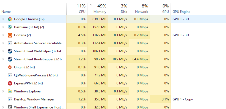

    So for about maybe 1 year maybe more my computer does this very random and very annoying thing where one of my HDD's does not show up in the bios and if I try to just boot in to windows it can take upwards of 5 minutes for it to finally bring me to login screen (I get stuck on the windows loading screen) I have my OS (Windows 10 Pro 10.0.17134) on a samsung ssd and 2 seagate 1TB HDD's. It is almost always the one specific HDD that stops being recognized however there has been one time where the other has stopped as well. I have tried the usual methods for fixing something like this, swapping SATA cables, SATA ports, I even re installed Windows and formated all drives to get it to stop doing it. I ran the hard drive health check thing from seagate on both drives both came up healthy. Generally it seems like pure chance as to whether or not the hard drive will come back and be recognized and I don't have to wait 5m for a boot on and SSD. I have yet to find any kind of pattern that could indicate what causes this although for some reason whenever my computer sustains some kind of "trauma" such as a power failure or one time I downloaded a software and clumsily gave myself a handful of virus / malware it seems to kaput out. Then finally for some reason it may come back, and I have to avoid shutting my computer down because I know when I reboot there is a likely chance i will lose my hard drive and it wont be recognized (and this is precisely what happened a couple days ago). I also just noticed I have a significant memory leak happening. Super slow boot time and unrecognized HDD 1c5638b4-3bec-4c24-8154-dc7169e31c67?upload=true.png
    I have 8gb of ram installed, and somehow I am using 4gb of memory despite task manager displaying I am using nowhere near that amount. Could there be a link? I just reinstalled windows to try and fix the leak but it is still occuring. I truly have no clue what to do. Is it a windows problem, a bios problem, the fact that the drives will randomly come back and turn up healthy in tests leads me to believe it isn't the health of the drives. Even weirder is that if I unplug the Sata and power cables for the 2 HDD drives Windows still takes many minutes to load into despite being on an SSD I know works.
