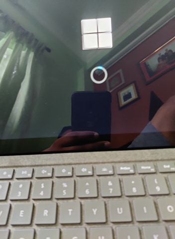

    Surface Gen 1 shows Windows logo and restarts again and again
    My surface pops up with windows logo and loading format pops up. Then after restart the system automatically. Please assist me on this. I tried everything. Volume + power button to open up bios nothing happened. Please assist me to open this and alternative medium to boot as well. Surface Gen 1 shows Windows logo and restarts again and again 238a243e-cb3b-45ce-b1ad-09e17f37b58d?upload=true.jpg
