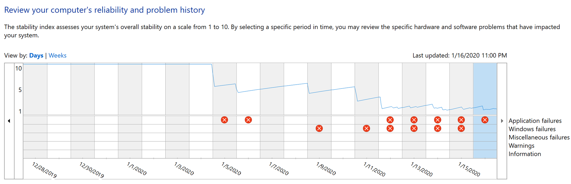

    Hi there. Hope someone here may be able to help me out with this issue. I recently bought a Surface Pro 7, and it is bluescreening several times per day, seemingly with a new error message each time. I am also experiencing random restarts without a visible bluescreen.
    These are the BSOD error messages I have seen:
    KERNEL_SECURITY_CHECK_FAILURE
    SYSTEM_SERVICE_EXCEPTION
    MEMORY_MANAGEMENT
    DRIVER_VERIFIER_DMA_VIOLATION
    From the minidumps I can also see a couple of others possibly the restarts without BSOD:
    KMODE_EXCEPTION_NOT_HANDLED
    DRIVER_POWER_STATE_FAILURE
    This is what my Reliability Monitor looks like:
    Surface Pro 7 frequently crashes to BSOD a3154a99-5b02-41b3-b7f7-4bd19f2ad627?upload=true.png
    Not so great. I started using the device on Jan 4th.
    I've uploaded five minidumps here all that were available, as well as System information
    All Windows Updates are installed. I did that immediately on first use, and again on the recent patch Tuesday.
    In searching for a possible explanation I have run Surface Diagnostic Toolkit*, Windows Memory Diagnostic, MemTest86, Checkdisk and SFC. None of these detected any problems.
    * In Surface Diagnostic Toolkit, I skipped the test which required the power adapter, as I did not have it available at the time. I also skipped the test involving the microphone.
    Significant changes I have made to the system:
    Jan 10th: Installed a 256 GB microSDXC card and formatted it with NTFS.
    Jan 13th: Upgraded from Windows 10 Home to Pro by entering a key I already owned and I also enabled Bitlocker on the OS disk.
    odds0ck, Jan 16, 2020
