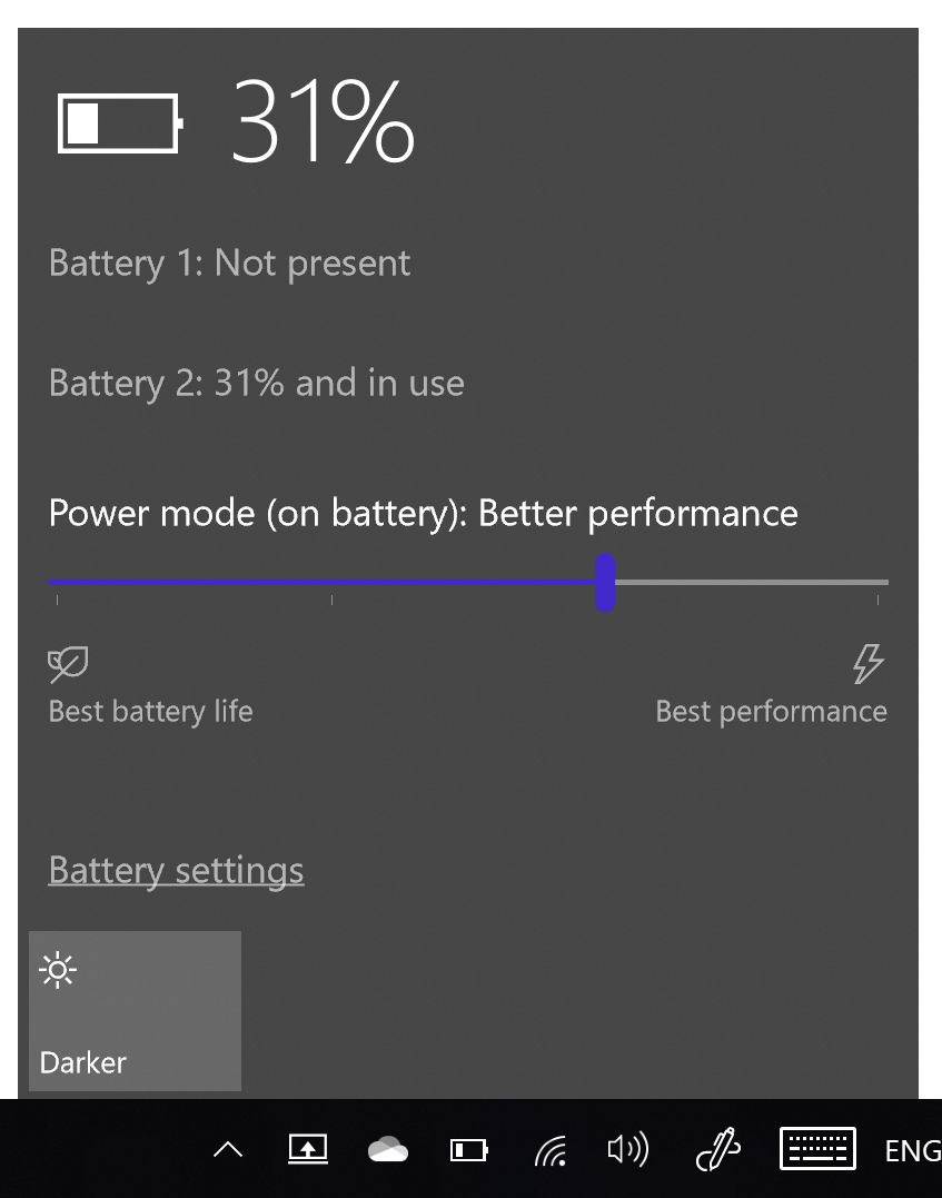

    Hey, my surfacebook is not detaching and also not charging. When I detach using paperclips and charge the tablet then tablet starts charging but still says that battery 1 : not present.
    SurfaceBook tablet not charging. Battery 1 is not present and Microsoft ACPI-Compliant... 0df01a1a-6d2f-4ebc-b441-7b5bdbbbc09d?upload=true.png
    Also I can't find Microsoft ACPI-Compliant Control Method Battery in device manager.
    Only Microsoft AC Adapter is available.
    SurfaceBook tablet not charging. Battery 1 is not present and Microsoft ACPI-Compliant... 497f2c62-f4d0-43a9-a39e-546bad3337eb?upload=true.png
