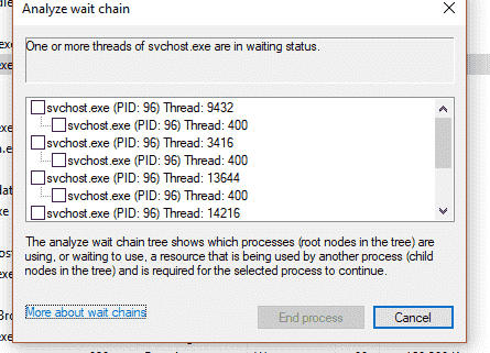

    My Windows Version 10.0.17134 Build 17134 Intermittently freezes. Everytime it freezes one of the svchost.exe processes is consuming more CPU than normal. If I analyze the wait chain there is always one thread everything is waiting on. This appears to be an issue with RPC and the multiple services that use RPC.
    How do I find what service owns this thread?

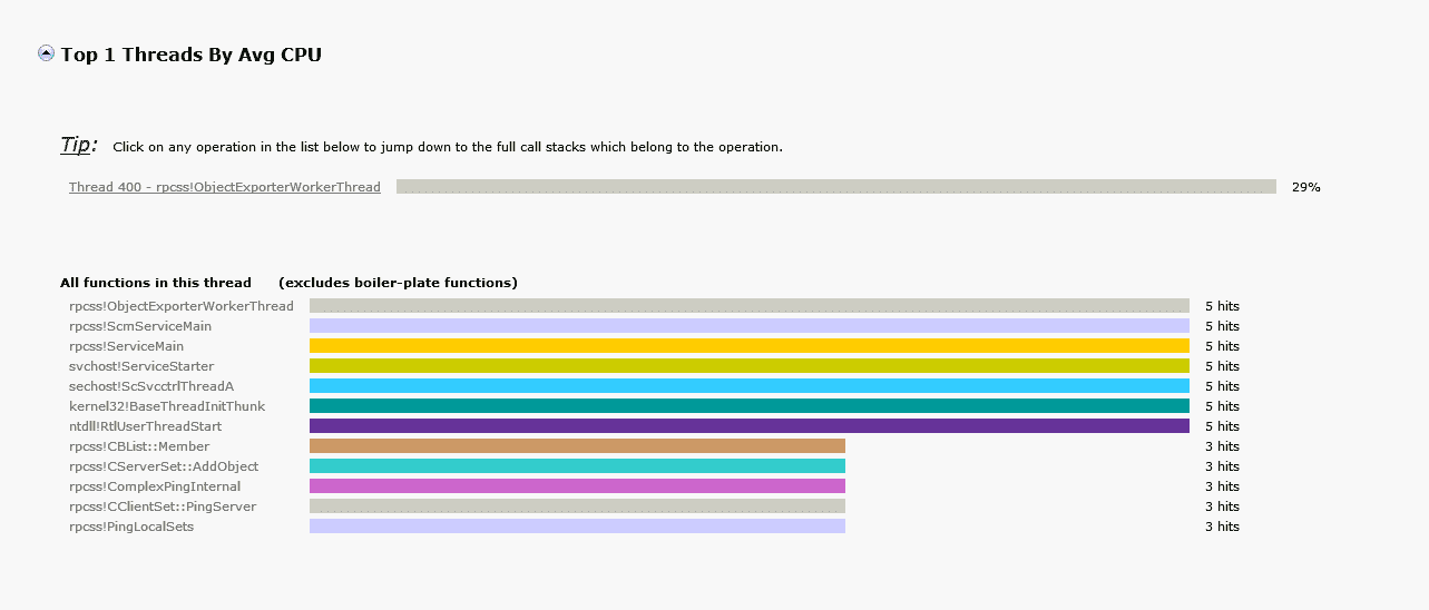

    I downloaded the Debug Diagnostics tool and it shows me information on the thread but I can't tell what is using this thread. See the wait chain below, and information on the particular thread captured from Debug Diagnostics.
    svchost.exe consuming CPU and waiting on a thread 75b22733-67e5-46cb-9a3f-82c7beab0bc6?upload=true.png
    Thread 1 - System ID 400
    Entry point ntdll!RtlUserThreadStart+21
    Create time 10/26/2018 9:07:25 AM
    Time spent in user mode 0 Days 00:30:59.187
    Time spent in kernel mode 0 Days 00:00:00.171
    Function
    rpcss!CBList::Member+61
    rpcss!CServerSet::AddObject+6e
    rpcss!ComplexPingInternal+3d4
    rpcss!CClientSet:svchost.exe consuming CPU and waiting on a thread :pingServer+49b
    rpcss!PingLocalSets+177
    rpcss!ObjectExporterWorkerThread+f0
    rpcss!ScmServiceMain+c2
    rpcss!ServiceMain+f1
    svchost!ServiceStarter+1da
    sechost!ScSvcctrlThreadA+22
    kernel32!BaseThreadInitThunk+14
    svchost.exe consuming CPU and waiting on a thread 93f28804-d80e-40d0-aea8-924345647e9d?upload=true.png

  3. Windows 10 - svchost running at max cpu with MpsSvc seen as the top consumer
    Based on your post, we may need to do further investigation. Kindly confirm which build is currently installed on your device. To check, follow the steps below:
    • Press Windows key + R, then type in winver.
    • Click OK.
    Meanwhile, let's troubleshoot the issue by performing steps below:
    Method 1: Start and stop the Services.
    • Click Start -> Run, type “services.msc” (without quotation marks) in the open box and click OK.
    • Double click the service “Automatic Updates”.
    • Click on the Log On tab, please ensure the option “Local System Account” is selected and the option “Allow service to interact with desktop” is unchecked.
    • Check if this service has been enabled on the listed Hardware Profile. If not, please click the Enable button to enable it.
    • Click on the tab “General” and make sure the “Startup Type” is “Automatic”. Then please click the button “Start” under “Service Status” to start the service.
    • Repeat the above steps with the other service: Background Intelligent Transfer Service (BITS).
    Method 2: If still the issue persist, then we suggest running the SFC scan.
    System File Checker tool is a utility in Windows that allows users to scan for corruptions
    in Windows system files and restore corrupted files.
    Regarding the issue with Windows Defender, if you have any third party antivirus software and firewall disable them temporarily and make sure that the Windows Firewall is turned on.
    Note: Antivirus software can help protect your computer against viruses and other security threats. In most cases, you shouldn't disable your antivirus software. If you have to temporarily disable it to install
    other software, you should re-enable it as soon as you're done. If you're connected to the Internet or a network while your antivirus software is disabled, your computer is vulnerable to attacks.
    Regards.
    Melchizedek Qui, Oct 27, 2018
