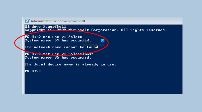

    System error 67 has occurred, The network name cannot be found System-error-67-has-occurred-The-network-name-cannot-be-found.png ​
    While attempting to run a Network Discovery scan or when trying to map a network drive from Command Prompt or PowerShell, you may encounter the System error 67 has occurred, The network name cannot be found. In this post, we provide the most suitable solutions to this issue. The most widely known cause of this […]
