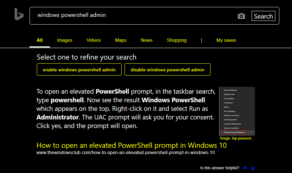

    1 open windows powershell admin System Image Backup Failed In Windows 10 f7aa958d-06e1-4e0b-87d9-b7c9db27229f?upload=true.png
    2 type chkdsk /r system will inform you that it will scan and fix disk when next restart
    3 sign out and restart
    4 I wait system fix about 3 house ago! however it have been fixed successful finally

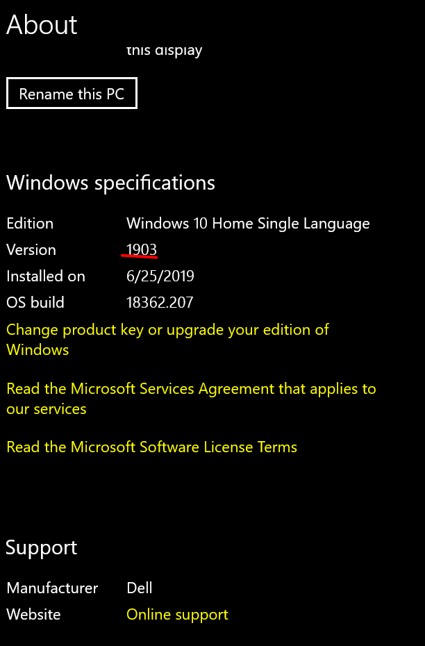

    This solution may apply to windiws 10 version 1903 System Image Backup Failed In Windows 10 925fea17-9fac-4db8-88d1-2724adb4dcb7?upload=true.png
