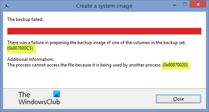

    Some PC users when attempting to create a system image backup on their Windows 10 device might encounter the error codes 0x807800C5 and 0x80070020. This post is intended to help resolve the issue with the most suitable solutions.
    The process cannot access the file because it is being used by another process
    System Image Backup fails with error codes 0x807800C5 and 0x80070020 System-Image-Backup-errors-0x807800C5-and-0x80070020-1.png
    When you encounter this issue, you’ll receive the following full error message;
    Create a system image
    The backup failed.
    There was a failure in preparing the backup image of one of the volumes in the backup set. (0x807800C5)
    Additional Information:
    The process cannot access the file because it is being used by another process (0x80070020)
    System Image Backup errors 0x807800C5 and 0x80070020
    If you’re faced with any of these error codes, you can try our recommended solutions and see if any of them help you resolve the issue.
