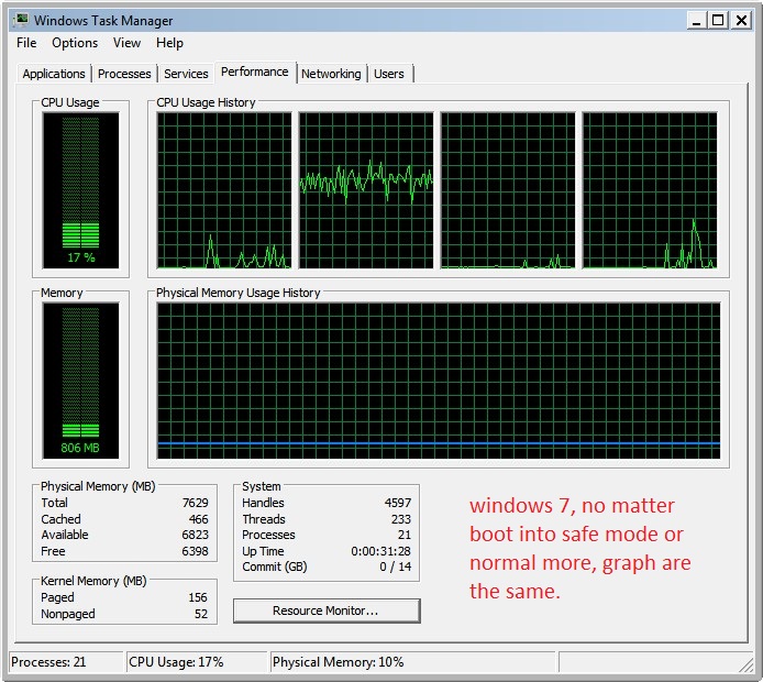

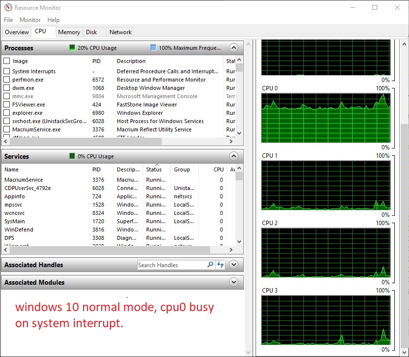

    I have a ASUS laptop that having high CPU usage on system interrupt problem that some people also have experienced. But I have dig out more details that I haven't found any one asked before. Details:
    1. when boot in windows 10 normal mode. CPU0 is busy on system interrupt. the overall cpu usage on system interrupt alone is 15%~19%.

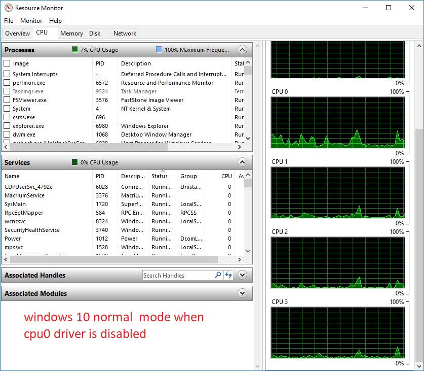

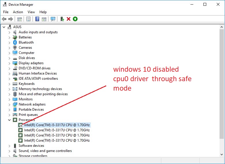

    2. when disabled cpu0 driver in device manager (can't disable cpu device driver in normal mode, have to boot into safe mode, disable from there), the cpu0 usage drop to close normal but still slightly higher than others. overall cpu usage on system interrupt alone is 3%~5% when laptop is idle. but it will go up when laptop is busy (can up to more than 20%, it look like proportional to cpu work load, I am not sure)
    3. boot into safe mode, the system interrupt usage maintain at 3%~5% (cpu driver is not loaded in safe mode, this is how I figure out to disable cpu driver for normal mode)
    4. boot into windows 7, (I have made windows 7 full back up when I upgrade to windows 10), no matter in normal mode or safe mode, cpu1 always busy on system interrupt.
    So, what is going on? Is win7 or win10 lied? What does processor driver do?
