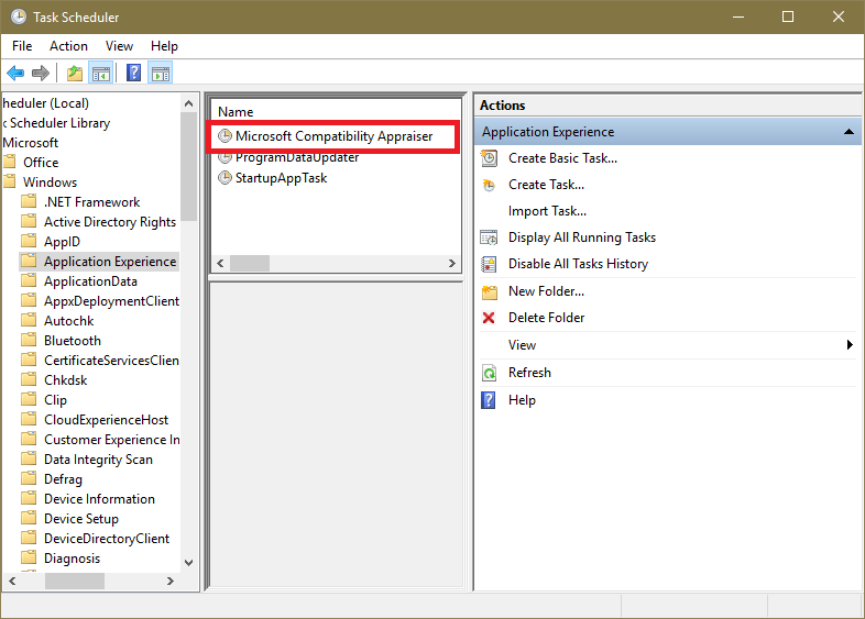

  4. "System" process using too much disk
    Windows 10: "System" Process using 100% disk
    The issue that you’ve encountered regarding the disk usage on your computer may be caused by some programs on the system that are running in the background. Some of these programs run when you boot your device. To sort out your concern, we suggest that you
    check if the Microsoft Compatibility Telemetry is running on the
    Processes tab from the Task Manager to check if the issue is not related to it. This is part of
    Microsoft Customer Experience Improvement Program that contains technical data about how the Windows devices and its related software is working, and then periodically sending it to the
    Microsoft server. To check it, you may follow the steps below:
    • Press Ctrl + Alt + Delete keys on your keyboard and select
      Task Manager
    • Click the More details button > Processes tab.
    • Look for Microsoft Compatibility Telemetry on the Name section.
    If the program is running, you may disable it from the Task Scheduler. This will reduce the disk usage on your PC to return its status to normal. To do this, you may proceed with these steps:
    • Click Start, type Task Scheduler, and then press
      Enter.
    • On the Task Scheduler window, go to this path: Task Scheduler Library\Microsoft\Windows\Application Experience.
    • On the Application Experience folder, look for Microsoft Compatibility Appraiser.
    • Right-click on it and select Disable.
    • Once you're done, you may restart your computer and check if the issue persists.
    "System" process using too much disk 93e7adf4-9fc0-4fd4-9935-17760c8a9afd.png
    Keep us updated about your concern for additional assistance.
    Joseph Ban, Jul 18, 2021
