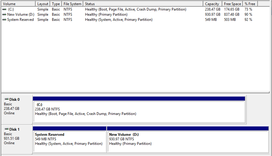

    as you can probably see in the screenshot , my System reserved Partition and the partition where my windows is installed are on totally different drives:
    windows: drive 0 (SSD)
    System reserved Partition: drive 1 (HDD)
    what i want is simple: move System reserved Partition from drive 1 (HDD) to drive 0 (SSD)
    thanks in advance

  4. Alan B Win User
    "Windows 10 couldn't be installed - we could update the system reserved partition"
    I think you mean "could not update", not "could".
    Suggestions:
    • Disconnect any other hard drives.
    • Run chkdsk /f on the System Reserved partition. You'll have to do this from the CMD prompt in Repair Mode.
    • Initially there were reports of some System Reserved partitions being too small for the upgrade. Search for details if the first two suggestions fail.
    Alan B, Aug 24, 2019
