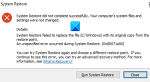

Discus and support System Restore did not complete successfully, Error Code 0x80071a90 in Windows 10 News to solve the problem; [ATTACH]When trying to restore the system using System Restore, the program may fail to […] This article System Restore did not complete successfully,... Discussion in 'Windows 10 News' started by WinClub, Feb 27, 2021.

  2. System Restore did not complete successfully error code 0x80070057
    I attempted to perform a system restore, however the following message appears, "System Restore did not complete successfully. Error code 0x80070057".
    The operating system is Windows 10 and anti-virus software has been disabled.
    System File Checker (sfc) has been performed which resulted in the following message: Windows Resource Protection did not find any integrity violations.
    I tried Safe Mode and the problem still persists.
    The last time I was able to successfully conduct a System Restore was 2018.
    Any help is greatly appreciated. Although please refrain from suggesting I restart the computer as I may loose the restore point.

  3. topgundcp Win User
    @Stevekir
    You might want to try:
    1. Click on Start button (1). Hold down SHIFT KEY+Click On Power (2) then click on Restart(3)
      System Restore did not complete successfully, Error Code 0x80071a90 [​IMG]
    2. The PC will reboot and get into the Recovery Environment
    3. Click on Trouble Shoot->Advanced Options->System Restore.
    topgundcp, Feb 27, 2021
