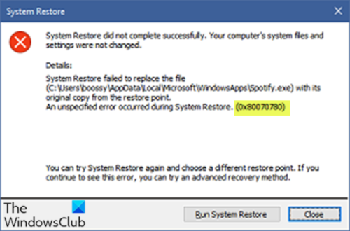

    In as much as System Restore is a great feature in Windows 10 that can be used to resolve most issues by reverting the system back to an earlier working state (snapshot), the feature has its own fair share of errors. One such error is 0x80070780, which you may encounter when you try to perform a system restore on your device. This post provides the solutions to this particular error.
    System Restore failed to replace the file, Error Code 0x80070780 System-Restore-Windows-10.png
    When you encounter this issue, you’ll receive the following full error message;
    System Restore did not complete successfully. Your computer’s system files and settings were not changed.
    Details:
    System Restore failed to replace the file with its original copy from the restore point.
    An unspecified error occurred during System Restore. (0x80070780)
    You can try System Restore again and choose a different restore point. If you continue to see this error, you can try an advanced recovery method.
    System Restore failed to replace the file, Error Code 0x80070780 System-Restore-error-0x80070780-1-500x330.png
    This can occur if a file is conflicting with the system restore operation. Investigations also revealed that this issue is not just with the Spotify app but numerous Windows Store apps.
    System Restore failed to replace the file (0x80070780)
