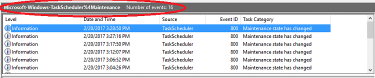

    Schedule task not repeating.
    This is the only event saved on the task scheduler folder, the operational log is empty.
    Task Scheduler Issue – Daily Trigger with Repeat Every 2 Minutes Not Working Works with One... 122073d1487598767t-schedule-task-not-repeating-event.png

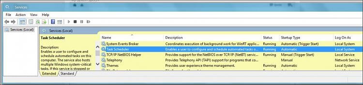

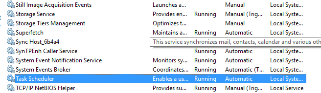

    My services.
    Task Scheduler Issue – Daily Trigger with Repeat Every 2 Minutes Not Working Works with One... 122074d1487598858t-schedule-task-not-repeating-services.png

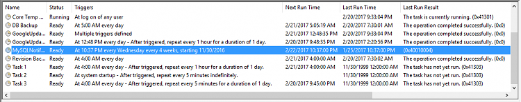

    And the task schedules
    Task Scheduler Issue – Daily Trigger with Repeat Every 2 Minutes Not Working Works with One... 122075d1487598936t-schedule-task-not-repeating-schedules.png
    All the non repeating task is working normally. I also deleted some of my tasks and test tasks.
    I created the 3 task task 1, task 2 and task 3. Then restart the system, then wait for more than 5 minutes before taking the screen shoot.
    First on the google update it should repeat every 1 hour, but the last run time is on 2 pm.
    The task 2 should run on start up, but i don't know it didn't run. because on my previous test, it runs.
    I was just starting using windows 10, around last November. then I just notice that some of my task is not triggering when i check my backup yesterday.
    Thanks

    Hello, welcome to tenforums. Could I suggest anyone who tries to answer this needs more detail.
    Please post a screenshot of all relevant parts of your scheduled task specification, including conditions, triggers and what you are scheduling.
    Also one of your event manager like that on the superuser page you posted.
    Also a screenshot like this please:
    Task Scheduler Issue – Daily Trigger with Repeat Every 2 Minutes Not Working Works with One... 122071d1487595954t-schedule-task-not-repeating-snap-2017-02-20-13.05.27.jpg
