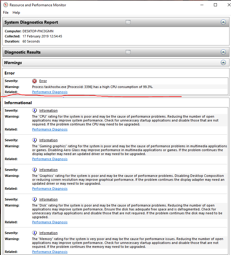

    Hey,
    I have been searching the internet all day and I have not found a fix for this. I have been playing some Overwatch and League of Legends and noticed that every 10 or so seconds the characters jump/snap to a location. I assumed it was lag or that my graphics drivers weren't updated but I have discovered it is neither. While using Photoshop CC, every 20 seconds while using the brush it freezes, I can move my Wacom pen around but when I try to draw or click nothing happens, a few seconds later it then fulfils all the actions done within the freeze.
    I did some scans of my pc and found this error when using the Resource and Performance Monitor, as well as these 'informational'.
    I believe this is what's causing the lag/freezing but cannot find a fix for it. My pc is only 8 months old, and it was build by myself and has been working perfectly since built. I have also this morning done a fresh install of windows 10 to see if that would fix it but it has not.

  2. taskhostw.exe Time - High CPU
    I managed to solve the issue by switching from Sleep mode to Hibernate. You can read more about it in
    my blog
    Boyan Mihaylov, Feb 18, 2019
  3. topgundcp Win User
    CEIP - rundll32.exe high CPU use in Win 10?
    This is a very first thing that I turn off after any Windows Installation (7/8/10).
    1. Control Panel->Administrative Tools->Task Scheduler
    2. Right click & disable 3 items as shown:
      taskhostw.exe has high CPU consumptionm of 99.3% [​IMG]
    topgundcp, Feb 18, 2019
  4. CptKoekie Win User
    Your are my hero. Problem solved. Thank you!!!
    CptKoekie, Feb 18, 2019
