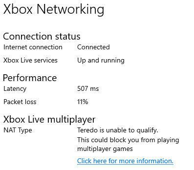

    teredo is unable to qualify
    teredo is unable to qualify 753d7d50-ed6c-488f-a777-497255c7d7c7?upload=true.png i have tried every thing.. but i cant fix it..

    Hi JayKay,
    Failure to obtain a Teredo IP address can occur when there’s an issue with your Teredo adapter, when a device on your network is blocking the Teredo protocol, or if there’s software installed on your PC that’s disabling
    Teredo functionality. If you haven’t tried the methods listed in the following articles yet, I would suggest you to try them first and see if it works:
    Note:
    Serious problems might occur if you modify the registry incorrectly. Therefore, make sure that you follow these steps carefully. For added protection, back up the registry before you modify it. Then, you can restore the registry
    if a problem occurs. To backup and restore registry key, refer to this
    link.
    If the issue persists, I would suggest you to
    uninstall
    and re-install the Xbox app to see if you can get it to work.
    • Right click the Windows icon on the taskbar and choose Windows PowerShell (Admin).
    • Copy and paste the following command and hit Enter:
      Get-AppxPackage Microsoft.XboxApp | Remove-AppxPackage
    • Reboot the computer once the command is executed.
    • Once the machine restarts, launch Microsoft Store and reinstall the Xbox app.
    After reinstalling the Xbox app, open Windows PowerShell (Admin)
    again and copy paste the following command to enable Teredo.
    netsh interface Teredo set state type=default
    Let us know how it goes.

    I understand that you are facing issues while playing games as Teredo is unable to qualify. For further clarity on the issue, please respond to the questions below.
    1. Are you aware of any changes made to the PC prior to which you weren’t facing this issue?
    2. Which build version of Windows 10 are you using currently?
    Refer the article
    Which version of Windows operating system am I running?
    Meanwhile, I would suggest you to refer the article
    and see if that helps.
    Note: Serious problems might occur if you modify the registry incorrectly. Therefore, make sure that you follow these steps carefully. For added protection, back up the registry before you modify it. Then, you can
    restore the registry if a problem occurs. To backup and restore registry key, refer to
    this
    link.
    In addition, as you have mentioned that Norton is blocking a port which is being used by Teredo adapter, I would suggest you to try disabling the antivirus and check if the status changes.
    Note: If you disable the security software or firewall, the system might be temporarily exposed to security threats and risks. Please make sure to turn it on after performing the steps.
    You can also create an exception in Norton for the ports, refer the article
    Use the Add Rule wizard
    The issue I'm having is my xbox app says teredo is unable to qualify and none of the steps in this link worked. Xbox Support
    Besides that I am not sure where this problem could be coming from.
