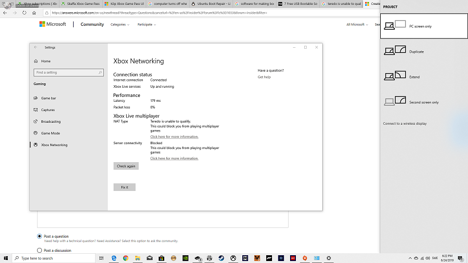

    I've a lot of problem with my NAT type as of late and with Teredo being unable to qualify.
    My attempts always ends up with one working but not the other one.
    So I'm curious to see anyone else has encountered this problem.
    And maybe just maybe have an solution for me.
    Teredo unable to qualify? 1b2f2b03-d903-45fa-b4f0-1c9fea89d6df?upload=true.png

    My NAT type says "Teredo is unable to qualify"
    Hi Kole,
    You may receive the error message Teredo is unable to qualify
    if your PC is unable to obtain a Teredo IP address. Teredo is a networking protocol that’s used to establish secure communications between clients and servers and to facilitate connectivity between devices behind routers that use network
    address translation (NAT). To resolve your concern, we suggest that you follow the steps provided on this
    link
    If you have already done those steps as you mentioned in your description, you may proceed to open the network ports and setting a static Teredo port by following the steps on this
    link
    Keep us updated with the results after performing the suggested solutions above.
