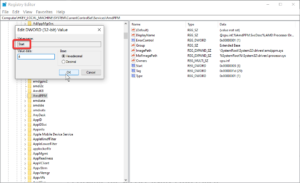

    5 min delay on cold start between login screen and bg screen
    Ok, let the powershell command run overnight
    If the command didn't solve the problem, the try these steps in order:
    1. Disable superfetch service
      • Empty the following folder c:\Windows\Prefetch\
      • Restart the computer
      • Si ça ne marche pas, passer à l'étape 2;
    2. Disable the AppXSvc from the registry: change the "Start" key value from 3 to 4 (see the screenshot)
    The delayed auto-start flag could not be set – Windows Service error [​IMG]
    zinou, Sep 29, 2020
