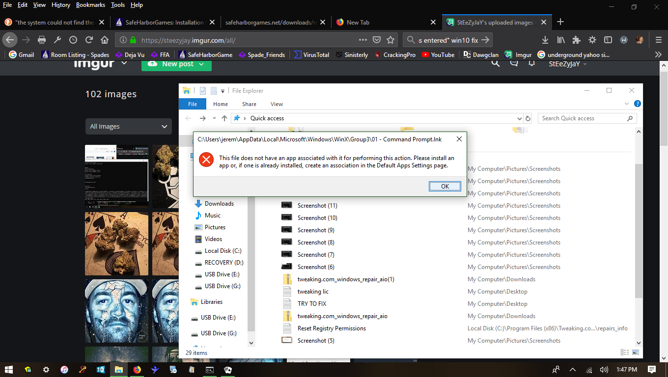

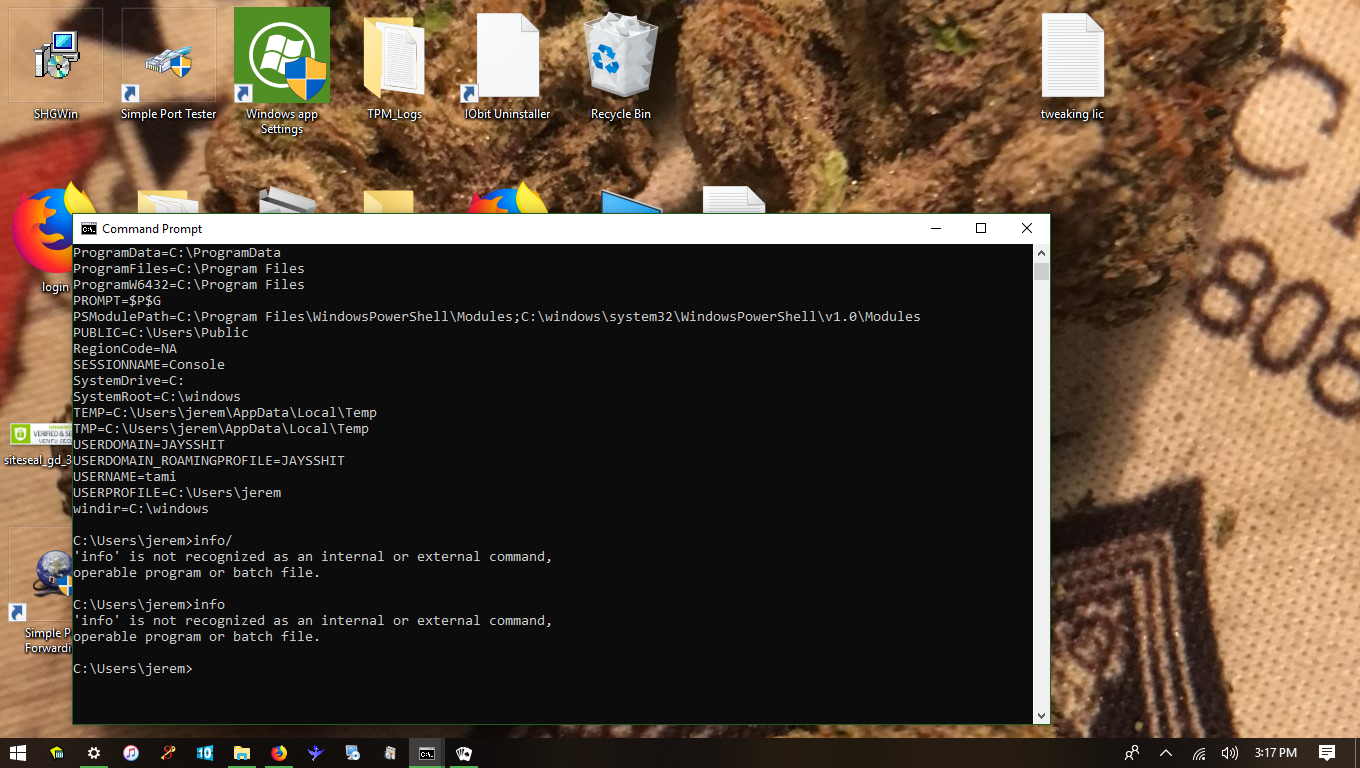

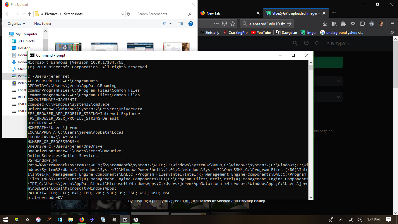

    Basically I believe a virus has changed my admin privileges and may even have erased my restore points. I cant open third party apps or access my admin privileges even though I'm logged in as administrator . only way to start up cmd with admin rights is to do it from safe mode
    im just trying to save what data i can off my laptop before worst case senairo i have a major crash or have to reformat completely. here are some screen shots of my system and error messages I'm getting . thank you for taking the time to help if you do.
    "the system could not find the environment option that was entered" [​IMG]
    "the system could not find the environment option that was entered" 9qEbvwa.png
    "the system could not find the environment option that was entered" xhMLxF6.png
    "the system could not find the environment option that was entered" 83ulkrO.png
    I'd be happy to try anything at this point I have been working on it for couple days now.

    Hello Shivam,
    This problem occurs in situations where Shutdown.exe cannot access the UserDomain environment variable. The shutdown task that is scheduled by using the
    at command runs under the System account. When the task is run under the System account, the UserDomain environment variable cannot be accessed because it does not exist. But the issue mostly occurs on server domains.
    We would suggest you to try the following steps:
    1. Boot your system into
    safe mode
    2. Press Windows key + R.
    3. Type sysdm.cpl and click OK.
    4. Click on "Advanced" tab
    5. In "Startup and Recovery", click on "Environment variables"
    6. Under "System variables" Click on "New"
    7. For "Variable Name", type in windir
    8. For "Variable value", type in C:\Windows
    9. Click OK on the all the dialog boxes that pop-up.
    10. Reboot your system in normal mode.
    If, however, your system is connected to normal mode, please refer to the following support article.
    Computer Does Not Shut Down and You Receive a "System Could Not Find the Environment Option That Was Entered" Error Message When You Schedule a Shutdown
    Task by Using the AT Command
    Let us know what happens.
