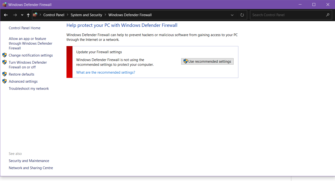

    Hello, i have started having a problem with the Windows defender firewall. When i try to restore it's defaults using the control panel, i get this screen:
    The windows defender firewall service refuses to start. 433a4e52-b5a8-4bd3-83d1-8a32c809c634?upload=true.png
    And when i press 'Use recommended settings' it gives me this error:
    The windows defender firewall service refuses to start. 5488af42-18ed-48de-bcdb-ed46fb9f2a47?upload=true.png
    When I try to start it through the Services app it says 'Windows could not start the windows defender firewall service on Local Computer. The service did not return an error. This could be an internal windows error or an internal service error.'
    I need to get windows firewall to work because I am trying to get glasswire to work as my main firewall but it needs windows firewall to work. I am planning on using glasswire as a firewall and Bitdefender as an antivirus and have been doing so for about 2 weeks. Suddenly Bitdefender found 'malware' and deleted it and I suspect that this might have caused this issue but I cannot be sure. Please help.
