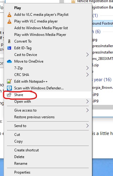

    If you try to email a file from File Explorer using "Send to", for example, you will get the error message in the title above. Here's what I discovered:
    In Windows 10, Windows Mail is a UWP app, not a standard program so it does not appear to operate in the same predictable fashion as a regular program even though it is specified as the default app for email.
    The solution is to use Share instead of Send to:
    When you right-click on the file(s) you want to email, select Share instead of Send to. Share is a little higher in the list of actions in the right-click menu.
    There is no email program associated to perform the requested action... 89c405d0-0bee-495b-9cb0-8d6b52f7d266?upload=true.jpg

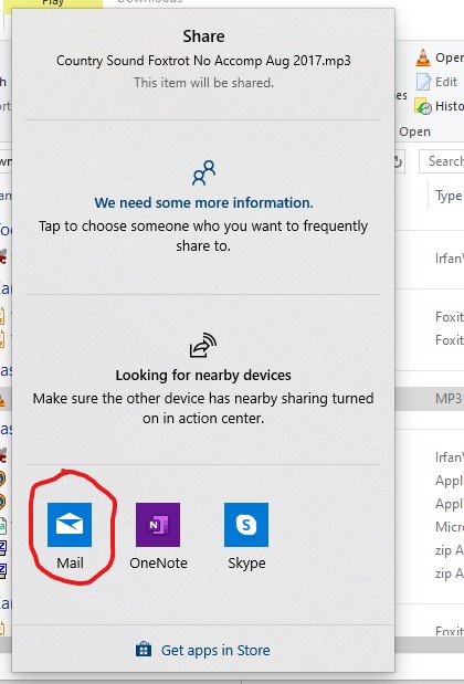

    When you click Share, the Share dialog should include the Mail app:
    There is no email program associated to perform the requested action... 62e26ef1-b9fe-4ecf-a577-3d62299bbc4c?upload=true.jpg
    Click the Mail icon. If you have multiple accounts set up in Mail, you'll get a dialog that asks you to select the account to send from. Select the desired account and you'll be put directly into the New Message dialog of Mail with the selected file(s) attached.
    I hope this helps at least a few of the hundreds of people who have asked this question in here. I have tried this on a Dell Latitude E7440 and a Surface Pro 4 with success!
