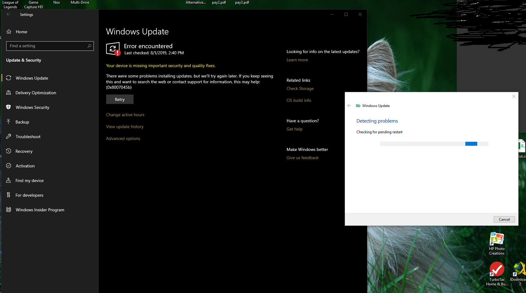

    There were some problems installing updates 0x8007045b Windows Update Error
    Hi everyone, I'm new here. I have this problem that windows does not update. I am running windows 10 version 1809 OS Build 17763.615
    Thank you!!!!!!!!!!!!!!!!!!
    There were some problems installing updates 0x8007045b Windows Update Error b0cf50c7-485a-4b30-b1f9-e51c3b873492?upload=true.png
    edg0023, Mar 19, 2020
  2. jds21 Win User
    I just did step one and they have just all installed.... thank you so much.... it was quite frustrating having that update window pop up every 5 minutes and failing to instal every time
    Thanks mate
    jds21, Mar 19, 2020
