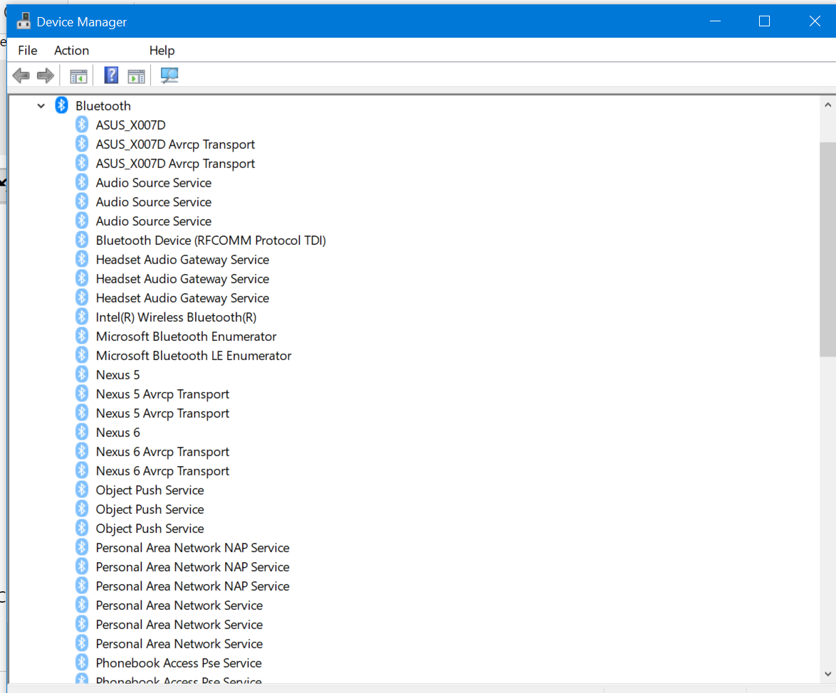

    Checked in Device Manager, Bluetooth is not there. Looked in the hidden folders, bluetooth is there. Screenshot is below.
    There's no on/off button to turn on Bluetooth 17033b9d-e33b-4863-89d0-1ad931cacc67?upload=true.png
    I read in the internet that I should uninstall Bluetooth related packages and reboot. Which ones should I uninstall?
    Or, is there another way to get back the bluetooth on and off button?
    Thanks!

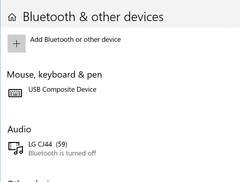

    Turned off bluetooth, now the button is gone.
    I bought a Bluetooth dongle (ZEXMTE), worked as I needed, but then I turn off Bluetooth under devices, and now I cannot get it to turn back on.
    There's no on/off button to turn on Bluetooth [​IMG]
    Ive ran the troubleshooter
    The device shows up under device manager (when I unplug and plug it in, it plays the noise but doesnt flash anymore)
    Ive tried reinstalling the driver
    Made sure Bluetooth services are running
    Also tried these steps:
    No button for bluetooth in action center - Windows 10 Forums
    blutooth not turning on in Windows 10 - Microsoft Community
    So I went into the device manager, right clicked, uninstalled the device. When I plugged it back it in, voila its working again.
    LVTHER, Apr 16, 2019
