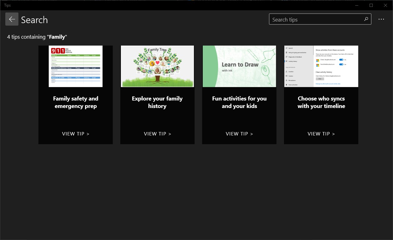

    Time With Family, Time For Family
    Btw, this is an especially good time to take a look at these things
    Time With Family, Time For Family 651b90cf-8c8f-4fd0-9e97-d00f361f2a2d?upload=true.jpg
    Cheers,
    Drew
    Time With Family, Time For Family 5a862955-dda2-4143-ada7-989c25eb6058?upload=true.jpg
    Drew1903, May 9, 2020
