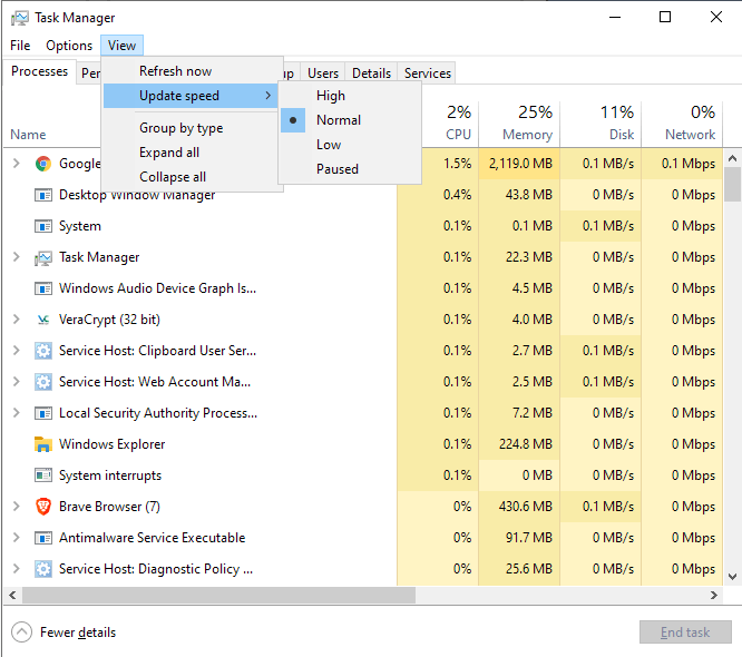

    One issue that you may have with these listings is that they tend to update fairly quickly. The order of process groups and processes may change when the listing updates and that may make it more difficult to focus on individual processes.
    The Windows Task Manager supports an option to change the update speed of the listings. Microsoft implemented the functionality in Windows 8 and it is part of the Windows 10 Task Manager as well.
    All you have to do is select View > Update speed to switch to a new update interval.
    Tip: how to change the Windows Task Manager update speed task-manager-update-speed-windows.png
    The Task Manager supports the following intervals:
    • High
    • Normal
    • Low
    • Paused
    Normal is the default interval; high speeds up the updating, low slows it down. Admins who want to freeze the process listing may selected paused to do so. Windows won't update the listing when paused is selected. Low seems to slow down the update interval to about 5 seconds.
    The update speed affects all displays (tabs) of the Task Manager and not only the process listings. The task manager remembers the selected update speed. If you have selected paused, it will launch with that update interval the next time you fire it up.
