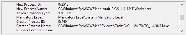

    For a few weeks, I noticed my computer's performance was dropping. I used a third-party process monitor and found that there is one process called TiWorker.exe which is using 40% -60% CPU usage. I stopped the process but after a few minutes it started running again.
    Before that, I had read several articles which said that TiWorker.exe is part of Windows Update and not a virus. But what happened to my computer was:
    - When I opened the Task Manager, TiWorker disappeared.
    - When I monitor Task Manager, the Task Manager suddenly closes by itself and I can see TiWorker running again from another monitor app.
    - When I finally got to see TiWorker in Task Manager for a while, I tried to check the file location but there was no response.
    I'm trying to figure out what triggers this process by enabling audit process tracing. This is what I got:
    TiWorker.exe process using a high CPU with strange behavior c5a95da6-6644-4d9c-afe9-2f26917bcb81?upload=true.jpg
    So what happened? Is this a virus?
