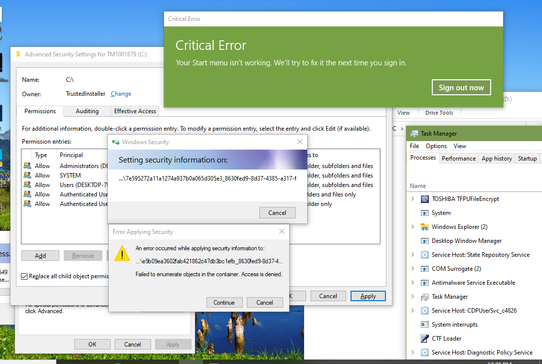

    Hello I was trying to learn how to reset permissions on Windows 10 under advanced security. The owner of my C: was not my name it was listed as Trustedinstaller, I wanted to correct this and made a change to my username that is the Administrator. Once this completed I was locked out of my task bar. I tried to use Icalcs to reset the permissions but this does not work.

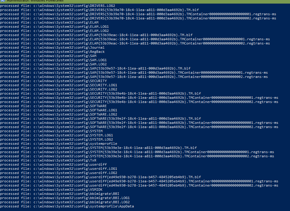

    preformed icacls reset in powershell to test this functionality seems it fails for windows 10 preformed for each folder to reset them
    Total Permissions reset for Windows 10 default permissions on local drive C:\. Icacls.exe... 6f063ce5-4145-47fd-9f96-ce99943e9ec5?upload=true.png
    It ran perfectly to test this functionality

    I ran SFC /scann now this did not fix it also reset the taskbar with powershell.
    where is a total premission reset to default admin and users of windows. If this fails why do we have the option to change this under all of C:?
    what is the reason we can change and take control of this over trusted installer if it causes system critical issues?
    Icacls.exe failed to reset and fix premissions.
