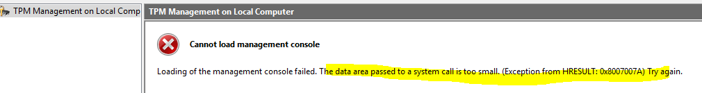

    Hi Folks,
    I am facing the following error after enabling TPM in BIOS and encrypting my C drive successfully - when i run tpm.msc in Win+R prompt :
    TPM Console Error 0x8007007A 475b382f-ac86-4479-9b8b-da5ce0f7e1c2?upload=true.png
    Is there any solution available for this so far?
    I am running Windows 10 Pro 1803 on Dell E6410 laptop.
    Thanks,
    Gulfaraz.
    Gul78, Apr 24, 2020
