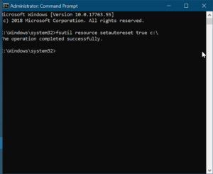

    1. Right click Start and select Command Prompt (Admin),
    2. In the Command Prompt window, type the following command, and press Enter:
    fsutil resource setautoreset true C:\
    Note: These steps assume that Windows is installed in the default location, on drive C. If this is not the case, adjust the drive letter of the folder path to match your configuration.
    3. Restart your computer, and then attempt to install the failed updates.
