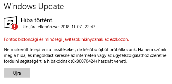

    The taskbar informs me "Some important updates are absent". Clicking on this icon Windows Settings app pops up with its Windows Update surface, where the familiar red exclamation mark greets me.
    Trouble with Windows Update 453e083c-6d14-465b-b4c0-34b226097dc7?upload=true.png
    I vainly pressed the "again" button, nothing happened. Searching the internet about error code "0x80070424" I tried to follow Microsoft's official experts' recommendations. I ran Command Prompt, I turned off and on some services with it (I'm not an expert but I trusted in Microsoft employees' aptitude). I've manually downloaded all recommended troubleshooters and updates.

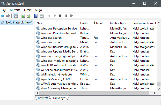

    2. When a coworker of yours suggested (for another user with a similar but not same problem) checking Windows Update among services, and if it wasn't run, would be. However I didn't find it there.
    Trouble with Windows Update 92284485-8764-4c0c-b746-4ba755bee10e?upload=true.png

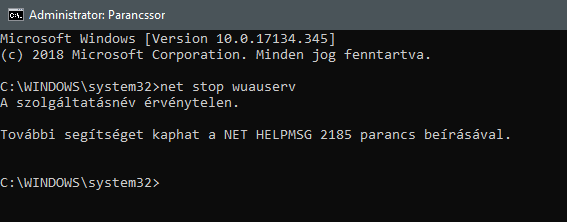

    3. As your coworker had also suggested that running Command Prompt as administrator I wrote the command "net stop wuaserv" then I got the following answer:
    Trouble with Windows Update 94506d2e-ada0-46bd-a13b-647de7fe1325?upload=true.png
    ("A szolgáltatásnév érvénytelen" means "service name is invalid".)
