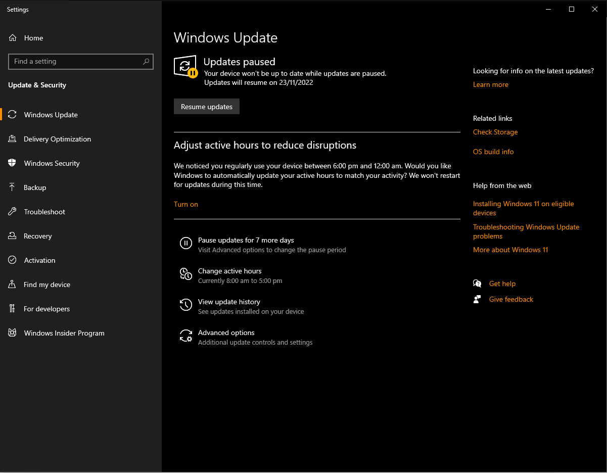

  3. JasperDev Win User
    Windows 10 Update KB5019959 causes BSOD on boot with error Stop Code: DPC_WATCHDOG_VIOLATION
    Hi John,
    Thanks for your reply.
    I'll be sure to report the issue via the Feedback Hub.
    However, as I've mentioned, I've already uninstalled the update and everything's fine. However, I have to pause updates to prevent Windows from reinstalling it. This means I'm not able to check for any other updates while it remains paused, since Windows automatically downloads KB5019959 and installs it when I shut down the computer. Here's a screenshot of what I mean:
    try every way possible, can not install update kb5019959 e7540512-c6e5-4b97-a5a3-c8bdbbc6ab4d?upload=true.png
    Since it seems that keeping the update isn't an option, is there a way for me to "skip" KB5019959 whilst also allowing other updates to come through?
    The "Show or Hide Updates" troubleshooter you linked didn't list KB5019959 (presumably because it's currently uninstalled as I write this).
    Looking forward to your response!
    JasperDev, Nov 24, 2022
