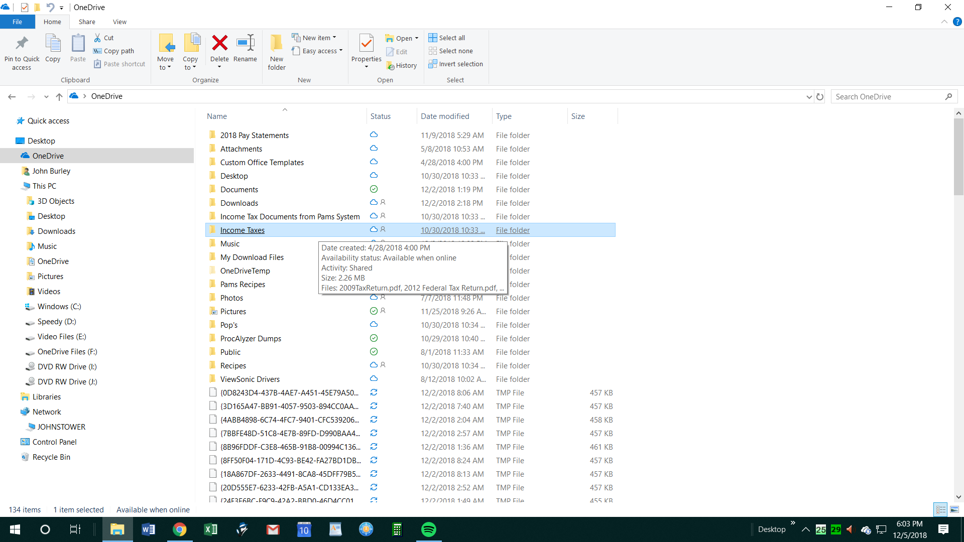

    I have two views of OneDrive showing in File Explorer and they seem to be driving my system, and iTunes, up the wall.
    As shown in the attached screenshot the first has the normal Blue Cloud symbol for OneDrive and has all the expected folders and files. The Second is under This PC but has a Document symbol on the folder.
    They both have the same number of folders and files so I am presuming that the OneDrive folder under This PC is simply another view. I believe that I created this little monster when trying to move some folders but am very reluctant to remove/Delete the "This PC" view out of concern that I might inadvertently delete the original OneDrive also.
    My CPU is running at around 30% capacity with nothing but OneDrive running. Part of that, I believe, is the system trying to Sync those two views.
    iTunes also can not seem to tell the real OneDrive from the "This PC" view and does not download music properly.
    Just need to know if removing the "This PC" version of OneDrive will affect the real OneDrive and what I need to do to safely remove the copy.

    Two views of OneDrive driing system crazy d904adf0-1ab9-4a81-9ed9-c82f898c87ef?upload=true.png
