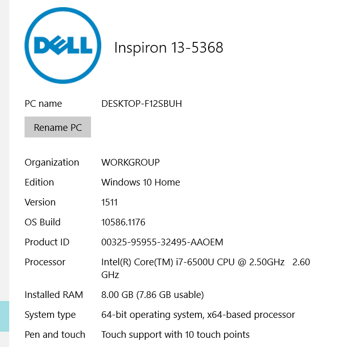

Discus and support UEFI : The disk layout for UEFI firmware isn't supported. in Windows 10 Installation and Upgrade to solve the problem; Windows won't update and I get the above message. This is my Windows info [ATTACH] What do I need to fix it.... Discussion in 'Windows 10 Installation and Upgrade' started by JudySnitchler, Mar 23, 2019.
  1. UEFI : The disk layout for UEFI firmware isn't supported.
    UEFI : The disk layout for UEFI firmware isn't supported. 2314ed39-ebc0-41f2-bea1-470877534b8d?upload=true.png
