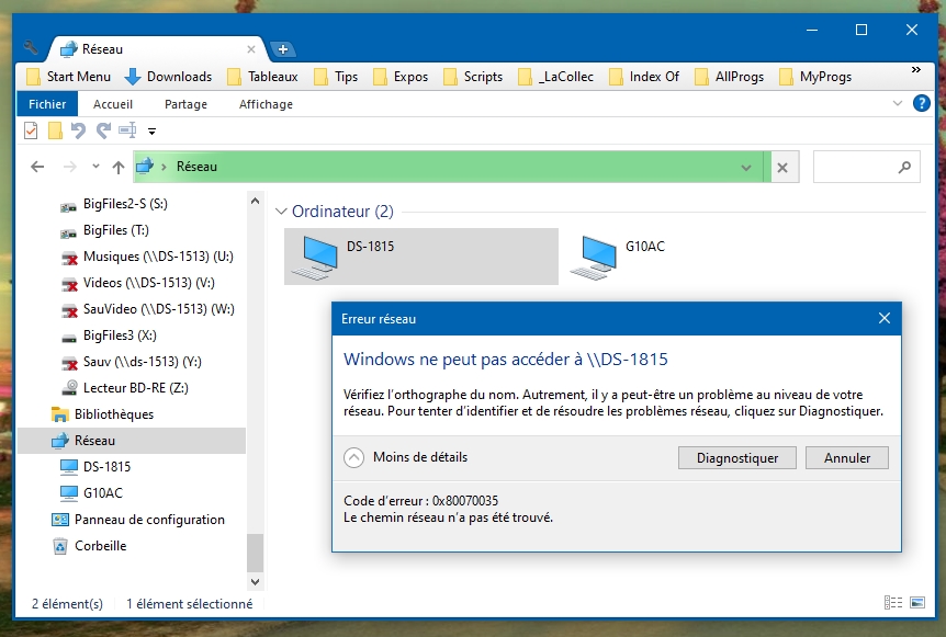

  1. Unable to access devices in my workgroup thru Explorer after 20H2 update.
    The names of the PCs & NAS on my network appear very slowly in the Windows Explorer, but when I click one of them or any mapping to them, I got the following Message I'm french and using a french version of Windows:
    Unable to access devices in my workgroup thru Explorer after 20H2 update. d84589c4-1274-4959-869c-d6bf1f8f18f2?upload=true.jpg
    Pings answer OK, Internet & NAS reachable thru browser OK, printing to the network printer is OK;
    Access from other PCs of my workgroup to the 20H2 PC works OK.
    Other items checked :
    1 In "Centre réseau et partage", the parameter "Modifier les paramètres de partage avancés" / "Privé" / "Recherche du réseau" is blocked on "Désactiver la découverte de réseau"
    the button "Enregistrer les modifications" does not keep the value "Activer la découverte du réseau". ;
    2 The service "Client DNS" is deactivated, and all options for launching are grayed out
    "erreur système 1058" if I try "net Start DNSCache"
    "erreur Le serveur RPC n'est pas disponible" if I try "ipconfig /registerdns"
    Thank you for having read my broken english... Have you ever seen that problem, and can you help me to find a solution ?
