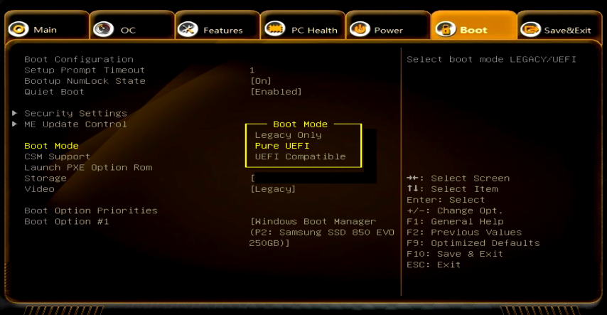

  3. How can I migrate a Windows 10 from BIOS/MBR boot to UEFI/GPT without reinstalling?
    In Windows 10 v1703 (Creators Update, Build 15063), there is a tool called MBR2GPT.EXE included which does all steps.
    Best is to boot from a Win10 v1703 DVD/USB drive to the repair option (WinPE) and run Command prompt (cmd.exe) under repair options. Now use diskpart and list command to see all drives.
    Now look or the disk number where your Windows is installed. This number is important for next step. Now run mbr2gpt /convert /disk:ID with the ID:
    Now, reboot the PC, enter the UEFI and change the mode from BIOS/legacy to UEFI only:
    Now save the changes, reboot and Windows 10 should boot. When you run msinfo32.exe you should see that Windows 10 runs now in UEFI mode.
    magicandre1981, Nov 10, 2023
