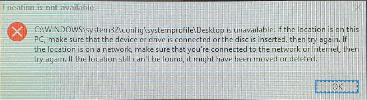

    Hello
    I have an Acer Aspire Z1-611 all-in-one with Windows 10 that is unable to load into Windows normally. The furthest I have been able to get is when logging in, it says there are some updates it's going to instal but after some time comes up with an error see attached image and after clicking OK goes to the normal desktop but without anything there and nothing is clickable.
    I'm not sure what the problem is exactly but I'm assuming it's corrupted somehow, perhaps it was turned off during an update or something. Anyway, I want to do a clean install of Windows 10 so I created a bootable USB which I have checked is working on another PC but when I try to boot from it on the Acer it won't recognise the drive.
    I have tried variations of different USB ports, disabling secure boot, enabling CSM and switching to Legacy, all without success.
    Any suggestions on another way to fix this would be greatly appreciated. I'm happy to completely format the HDD if necessary.
