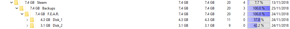

    Windows 10 Pro 1803, 17134.407.
    I'm backing up my steam files again and I forgot about backing up F.E.A.R. to a different name unfortunately it looks like steam was able to not only create a folder with that name but chuck in a few sub folder with lots of files (20 files in two folders). Treesize can see the folder and sub folders but when I try to expand the folders everything vanishes and when attempting to delete the F.E.A.R. folder it has an error.

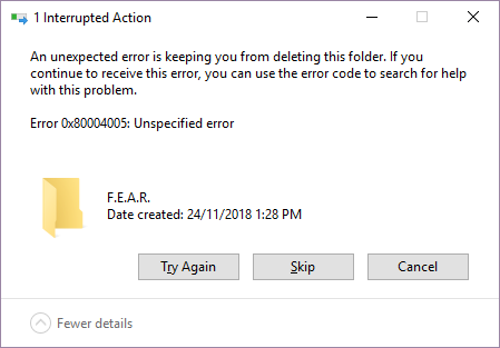

    But when I'm in windows and trying to remove said folder it says there is an unexpected error (which could have happened previously but since I backup every year or two it has been a while). I tried to do the rd FEAR~1 trick but that doesn't work anymore either and while I did consider upgrading to 1809 to see if that would do anything I realised this was in the programs folder and not users (and probably crash the upgrade knowing my luck).

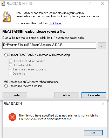

    I've tried to use powershell's remove-item and even downloaded file assassin and that has an error detecting the file.
    Unable to delete folder 4767e472-e8d3-47a1-a07b-3ac91a9ba377?upload=true.png
    I tried to replicate the issue by manually creating a folder with the same name but windows always seemed to remove the last . (which I'm assuming is what's causing the error since I can delete those folders fine) so could someone please look at the method that steam is using to create the folder and get it to also remove any last . in folder names when creating them and hopefully patch it so I can remove this stupid folder.
