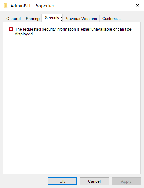

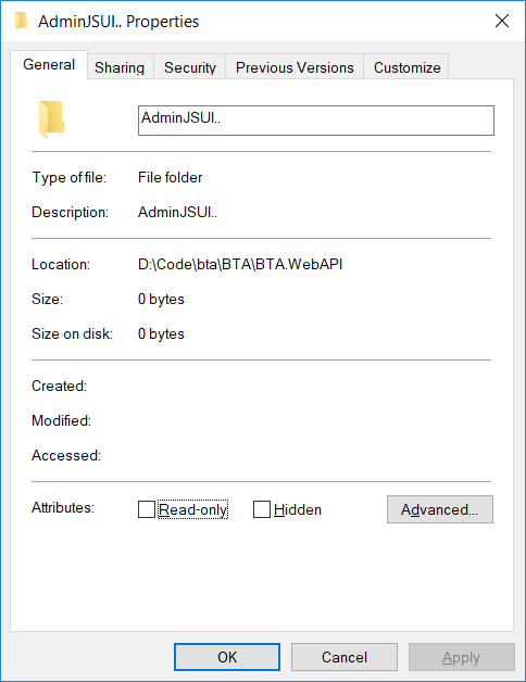

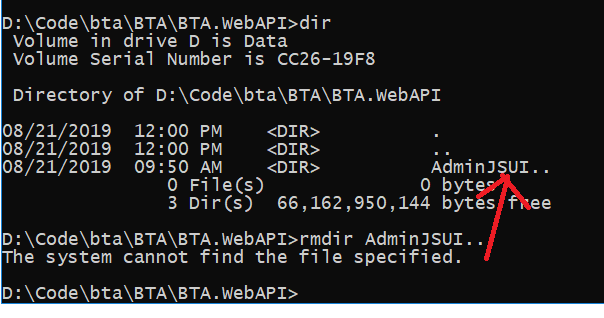

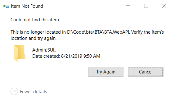

    Unable to delete a folder.
    Unable to Delete invalid folder 599b18ba-ecf9-4895-80c5-8b443ca40e51?upload=true.png
    I have..
    Attempted....
    Delete the parent folder
    Change ownership of parent folder and pass to children
    rmdir folder
    del folder
    rmdir folder using volume path
    del folder using volume path
    del folder in "safe mode"
    rmdir folder in safe mode
    sfc /scannow (passed)
    disk check tools (passed)
    Unable to Delete invalid folder a0899a0e-e061-4cba-9189-149f93e0e8be?upload=true.png

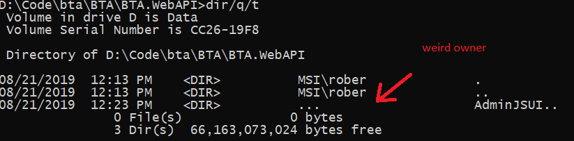

    Some weird things I've noticed in the last 2 1/2 hrs of trying to delete this folder.
    Unable to Delete invalid folder d971d55b-9429-4ca1-88af-fe7adea0a2c2?upload=true.png
    Unable to Delete invalid folder c83a64a0-6261-40f4-8883-075926258bee?upload=true.png Missing Timestamps...
    Unable to Delete invalid folder c3e95288-b58d-480d-918c-3d44685f3fce?upload=true.png
    RobertEugeneOR, Aug 21, 2019
  2. topgundcp Win User
    Unable to delete a folder - Invalid folder name
    Suggestion:
    1. Run chkdsk x: /r to make sure that there's no HD corruption.
      x: is the drive containing the folder you want to delete.
    2. Try to delete the folder again. If still does not work, go to step 3.
    3. Download: Download - Linux Mint and create a bootable USB using: Rufus - Create bootable USB
    4. Boot up with Linux Mint and try to delete the folder again.
      NOTE: Unlike WinPE. Linux does not have any Windows permission imposed to it so it is easier to delete.
    topgundcp, Aug 21, 2019
